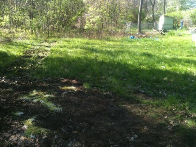

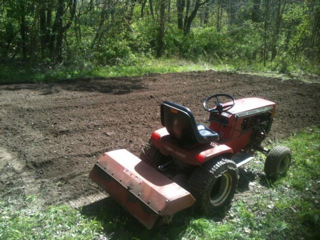

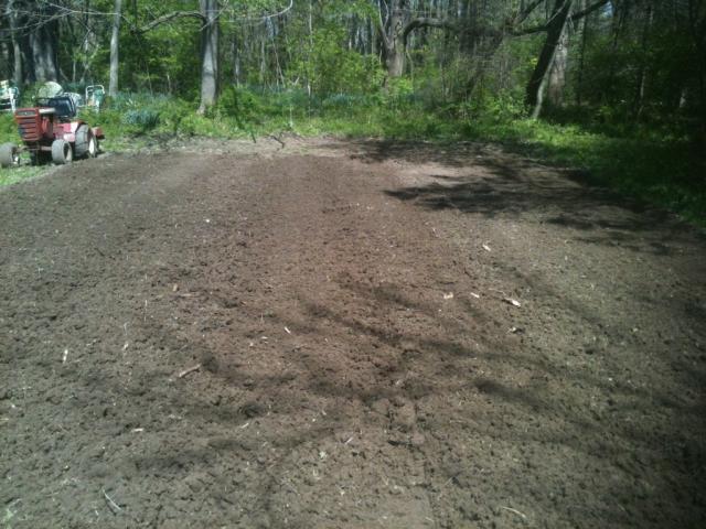

Paul D. 26 #1 Posted April 7, 2012 Got to put I a garden at the in-Laws today. It was pretty tough going, alot of clay in the soil. That 14 horse kohler didn't even struggle but my clutch plate kept slipping. Don't know if there is an adjustment for that or if I need to replace it. Anyone with any input on that I would greatly appreciate. Here are some pics cause I know we can't live without those. before I got started Sent from my iPhone using Tapatalk Share this post Link to post Share on other sites
AMC RULES 37,261 #2 Posted April 7, 2012 Wow, looks like the tiller made short work of it...approximately how much time did it take you to achieve that level of soil prep Paul? Share this post Link to post Share on other sites
Paul D. 26 #3 Posted April 7, 2012 It only took an hour and a half to two hours. And only about a gallon of gas! I really expected it to be an all day affair but it really nicked it out. Like I said the only down side was my pulley slipping. I wouldn't have been surprised to have the belt slip, but the pulley really surprised me. Sent from my iPhone using Tapatalk Share this post Link to post Share on other sites
