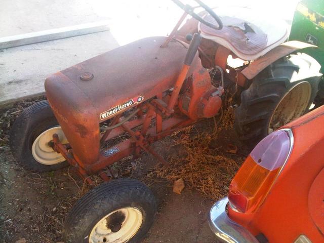

Pilot78 7 #1 Posted April 5, 2012 Group, Please excuse all the newbie questions... especially if they have been asked before. Looks like I will be picking up my first horse tomorrow, and dis-assembly and sand blasting will follow. My question is what color of Red? Is there a specific Wheel horse red... a paint # from a specific vendor or do you go with the closest bright red out there? I will be picking up this RJ58 tomorrow....it's original red looks faded orange. Brian SLC-UT 2 Share this post Link to post Share on other sites

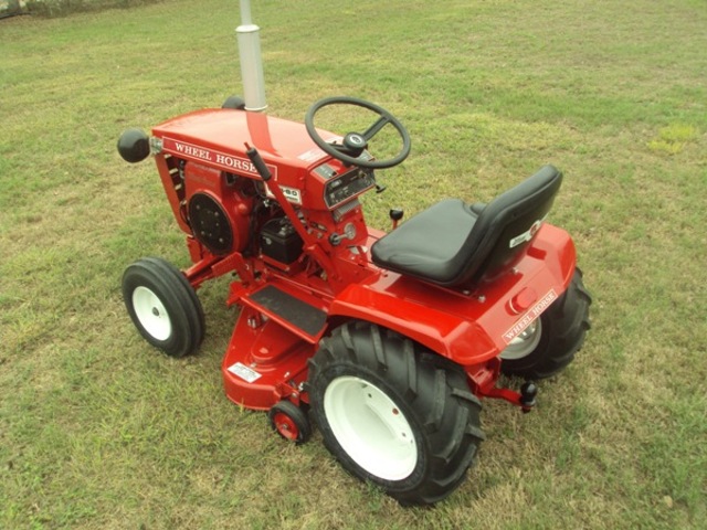

bowtiebutler956 650 #4 Posted April 5, 2012 I just used International Red in an industrial enamel with plenty of hardener. Turned out pretty well. Here is a pic. Matt :flags-texas: Share this post Link to post Share on other sites
bowtiebutler956 650 #5 Posted April 5, 2012 I hit post without putting in the pic. Oops. Matt :flags-texas: 2 1 Share this post Link to post Share on other sites
1maidenfan 203 #6 Posted April 5, 2012 I hit post without putting in the pic. Oops. Matt Nice looking tractor ! :happy-smileygiantred: Share this post Link to post Share on other sites
