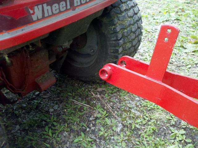

gsinal 1 #1 Posted April 2, 2012 Hi all I am still learning about my wheel horse. So here is a question about my '98 520hc. i got a moldboard plow with it and i am trying to attach it i looks like it goes where the hitch goes in the back but it seems to close and the part that it looks like you hook up the lift chain will hit the gas tank. am i missing a piece. here is a picture because everone likes to see pictures. any help would be great for i would like to turn over some ground for a new garden.. thanks Share this post Link to post Share on other sites
mrocket49 23 #2 Posted April 2, 2012 The part in the picture is the clevis hitch. This attaches to your transaxle with the same pin that attaches the draw bar hitch. The lift chain (which attaches to the top hole in the clevis hitch) appears too long, though. Share this post Link to post Share on other sites
kpinnc 18,466 #3 Posted April 2, 2012 Older tractor, but the same hitch. Yours connects the chain where mine has the cable attached. Just put a bolt through the link that works best for you. Share this post Link to post Share on other sites
