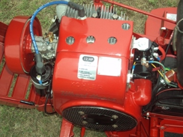

bowtiebutler956 650 #6 Posted March 31, 2012 Kohler replaced the Carter's with Walbro's when the EPA got on them about hydrocarbon output. Walbro's are a direct fit, but most lack an adjustable high speed jet. The Walbro replacement carb I got off has high speed adjust on my K-301. I know the pic isnt real clear but there are three screws on the carb, high speed, low speed, and idle speed. Matt :flags-texas: Share this post Link to post Share on other sites
