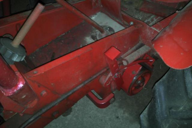

wp205a 43 #10 Posted December 5, 2012 I just posted a picture of a Cushman Truckster parking brake lock. If I could get the specs on an 854 pb lever, maybe I could make one starting with it? Share this post Link to post Share on other sites
Kelly 1,028 #11 Posted December 5, 2012 Send me a PM, I should have the park brake handle, and I know I have the side cover. 1 Share this post Link to post Share on other sites
wp205a 43 #12 Posted December 5, 2012 And I just posted another pic showing what I think to be an uncorrectly assembled brake assy. Fun times. (No, I got it that way) :ychain: Share this post Link to post Share on other sites
wp205a 43 #13 Posted December 6, 2012 I've been told I have a later uni drive on my 854. 2 Pics are just below the shout box now, and are in my gallery. Anybody have pics showing their solution to my problem? Share this post Link to post Share on other sites

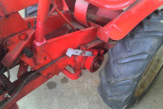

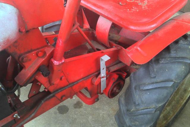

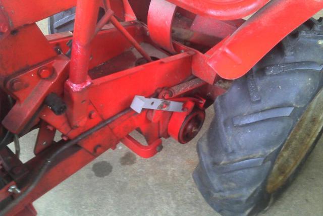

wp205a 43 #14 Posted December 26, 2012 (edited) Posting 2 pics showing my temporary (hopefully) solution. Need to add a wave washer to keep it from accidentally engaging. Edited December 26, 2012 by wp205a Share this post Link to post Share on other sites
sscotsman 138 #15 Posted December 26, 2012 Wip, your photos arent showing up! im not seeing anything.. Scot Share this post Link to post Share on other sites
wp205a 43 #16 Posted December 26, 2012 I'm a little slow Scot, should be there now, thanks Share this post Link to post Share on other sites
wp205a 43 #17 Posted December 31, 2012 A little Valspar IH (WH) red and a wave washer have me in business, would still like to get the correct parts. Good night all Share this post Link to post Share on other sites
