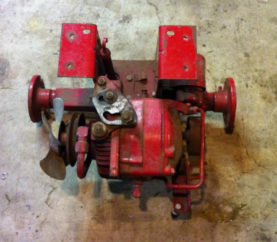

dwcphoto 7 #7 Posted March 29, 2012 Here's a photo of one for sale. Does this look familiar?? thanks, dwc Share this post Link to post Share on other sites
dennist 139 #8 Posted March 29, 2012 Here's a photo of one for sale. Does this look familiar?? thanks, dwc That has a filter and is an Eaton 1100 Share this post Link to post Share on other sites

dwcphoto 7 #10 Posted March 29, 2012 Hi, I went out and looked and sure enough it's not centered. It's a Uni-Drive part no. 2988185. That's what's on my tractor. The photo is one I'm looking at buying. I'll check that other post. Thank you for your help. Any tips or ideas are very welcome. best, dwc Can that 1100 be installed on my 518? thanks, d Share this post Link to post Share on other sites

dwcphoto 7 #13 Posted March 29, 2012 The guy that has that hydro in the photo is at a distance. Is there a part number or anything that he can check to make sure it's an 1100? Thank you, d Share this post Link to post Share on other sites
Sparky-(Admin) 26,621 #14 Posted March 29, 2012 The Eaton 1100 has an oil filter and the Eaton 700 does not. I see an oil filter on the upper right side of the tranny picture that you posted. If it was a Sundstrand the oil filter points to the side of the tractor (I'm pretty sure about that ) and not the rear like the Eaton 1100 does. Hopefully someone here can verify what I said about the Sundstrand. Mike........... Share this post Link to post Share on other sites

pfrederi 21,274 #19 Posted March 29, 2012 Filter out the back Eaton 1100 Filter - - - out the side Sundstand (either Gearmotor or Piston to Piston) Share this post Link to post Share on other sites
