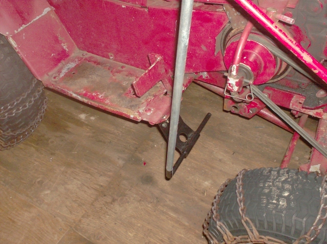

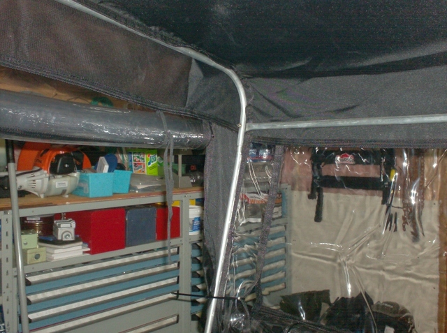

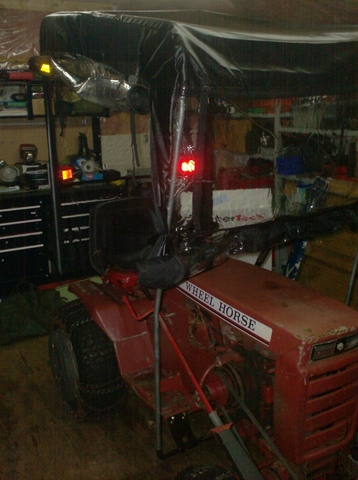

Steve B. 30 #1 Posted March 9, 2012 Wasn't sure if this was the best place to put this or not. Here goes anyway. These are 'cuz ce318 asked for pics of my cab over here: As I mentioned in that post, the cab is a Berco "universal" tractor cab. A shot from up front: The front skirt is rolled up and zap strapped because it lines up nicely with the PTO and flywheel screen on the engine. I figured moving parts vs. plastic legguard was likely a bad combination. A couple shots of the mount points: The rear plate bolts onto the tow bar and the red cargo strap is just to keep the thing from flailing back and forth. One more of the inside top facing forward: The tubing used is fairly sturdy. I had the thought to drill and pin it where the tubes slide together as initially this one corner kept popping out. The cargo strap seems to have stopped that by arresting some of the cabs movement. All in all, not a bad cab... it did keep snow from blowing back into my face so I could pay attention to what I was doing. Honestly, I fully expected the thing to wind up in a crumpled heap beside the driveway after I trashed it in a fit of rage, but so far so good. This cab was definately not designed with a Wheel Horse in mind though. If anyone would like measurements or pics of any particular part, ask away and I will endeavor to provide. Share this post Link to post Share on other sites

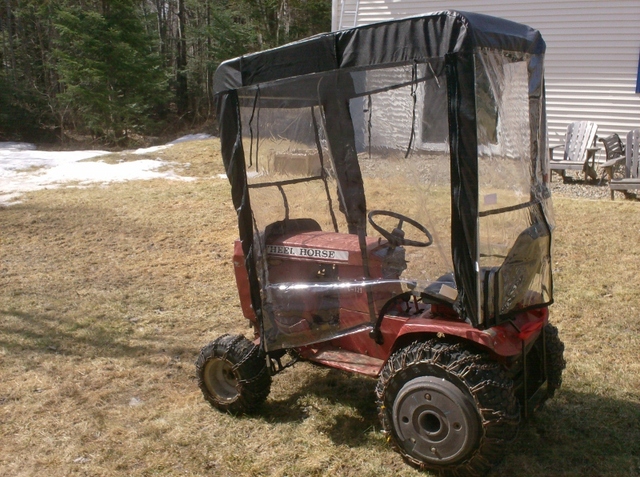

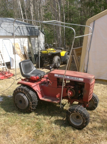

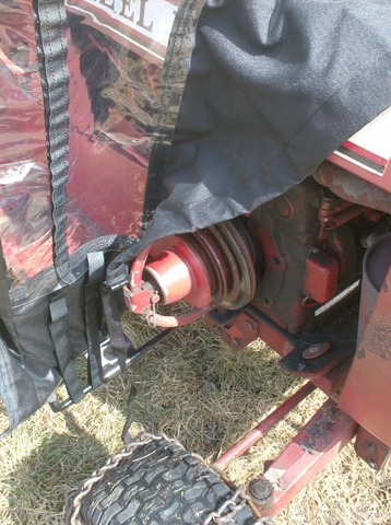

Steve B. 30 #4 Posted March 25, 2012 So a couple days of mid-20's (mid-70's for those south of the border) made pretty short work of the snow around home. That means it's time to swap blower for mower. As I promised ce318, here are a couple pics of the cab from a distance. with the sides still rolled up - and dropped This is why I had the front rolled up (note the proximity to the rapidly rotating parts) and as it was dissasembled: Pretty simple frame, my intent is to manufacture a better cab for next winter. Time will tell whether I get to it or not, my honey-do list is filling up rapidly. :teasing-whipyellow: Share this post Link to post Share on other sites
