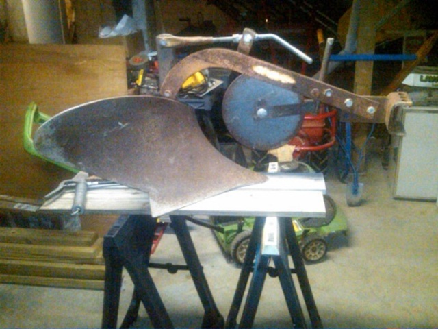

leeave96 495 #7 Posted March 9, 2012 So I put the moldboard plow on some saw horses and here's what I had to start with: Share this post Link to post Share on other sites

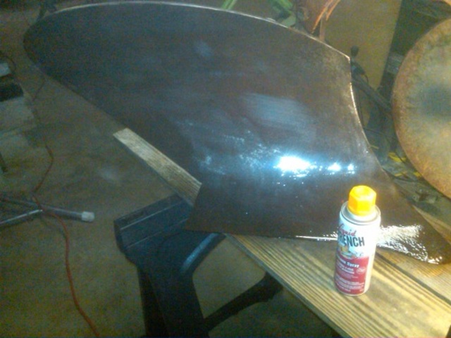

leeave96 495 #8 Posted March 9, 2012 Next I decided to smooth the moldboard - rid if of rust so the sod can come off, once I did this, I sprayed the moldboard with some silicone. I may get some slip plate from Tractor Supply tonight to put on it. BTW, Slip Plate is great for the underside of a mowing deck too. Before and after pics: Share this post Link to post Share on other sites
leeave96 495 #9 Posted March 9, 2012 Next up was adjusting the coulter. It should only sway such that it is parallel with the landside of the plow and swing away from it. From one pic you can see the coulter is hitting the beam on the plow. Two pics show the coulter adjusted, parallel from the beam and able to swing away. Share this post Link to post Share on other sites
