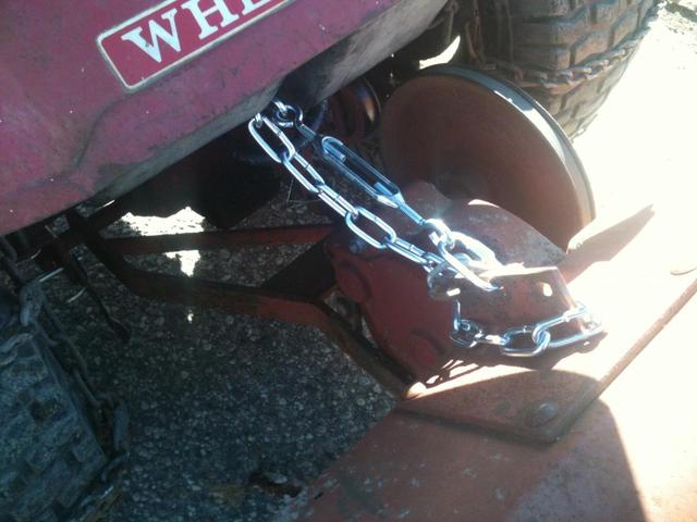

Tim 97 #14 Posted March 10, 2012 take out some of the links and put a turnbuckle in you can tighten and loosen from your seat when you done tilling go to level ground, drop the tiller and then tighten, the tiller will raise higher for travel when tilling just loosen the turnbuckle before you start alot easier than messing with the chain Share this post Link to post Share on other sites

Paul D. 26 #19 Posted March 10, 2012 Great idea Tim. I just picked up a turn buckle at the farm store. I'll let ya know how it goes. As far as the weights I think your right Kelly, it handles just fine tilling without them even when doing untilled land but it sure does steer easy. I'm afraid of doing a wheely off of the ramps Share this post Link to post Share on other sites

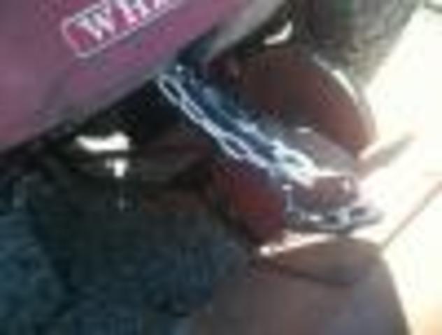

Paul D. 26 #21 Posted March 10, 2012 Added in the turn buckle. It really helped. I was able to set it so it raised it just short of the pulley arm hitting the back of the transmission case. Here's my ground clearance. Only way to get more than that is to redesign the pulley mounting bracket. Share this post Link to post Share on other sites
Paul D. 26 #22 Posted March 10, 2012 Let's try again maybe with the pic this time Share this post Link to post Share on other sites
