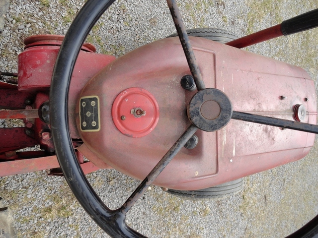

doynger69 41 #1 Posted March 1, 2012 Hi Horse heads, I have an old 1961 Wheel Horse 401 Suburban. It's missing the rubber grommet in the hood where the steering shaft comes through. Does anyone no what size grommet is used on the hood? Thank you all in advance. I always get the answers I need here. Eric in western, Pa. Share this post Link to post Share on other sites

BIGKUZ 4 #5 Posted March 2, 2012 just tried measuring whats left of my old one looks like 1 1/8 od -5/8 id -5/16 thick Share this post Link to post Share on other sites

CasualObserver 3,416 #7 Posted March 2, 2012 Kelly, I assume they're factory. My 400 has one. I'd measure it, but that's worthless. It's elongated and warped from age. For a replacement, I'd just look at the local hardware store. A good one (Ace/Hardware Hank/True-Value/etc...) will have those rows of boxes with screws/bolts/pins/clips/etc... Measure the hole in the hood and find something that fits sheet metal and has a 3/4" ID. (the steering shaft is 3/4".) 5/8 would be tight and would be harder to turn. Share this post Link to post Share on other sites
doynger69 41 #8 Posted March 3, 2012 Good news I went to my local Ace Hardware ang got a package of 3 for under $2.00. There made by Garden Bender Part no. GHG-1575. 3/4 INCH. Fit very nicley. and there made in the USA. Garden Bender Milwaukee, Wi. 53209 1-800-822-9220 www.gardenbender.com Thanks all. Good luck Eric Share this post Link to post Share on other sites
