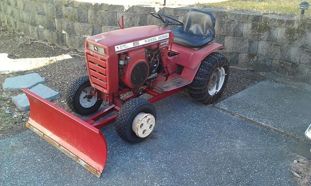

chevrat68 19 #1 Posted February 26, 2012 I have finished my plow resto and mod. Custom angle lever arm, with cable and pully pin linkage. Extended 5 inches to alow all 5 angle positions. Next will be my single bottom plow and disks. Share this post Link to post Share on other sites

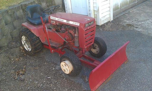

chevrat68 19 #2 Posted February 26, 2012 Another pic Share this post Link to post Share on other sites

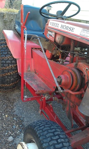

chevrat68 19 #3 Posted February 26, 2012 Lever and pulley assembly 1 Share this post Link to post Share on other sites

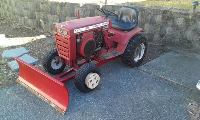

chevrat68 19 #4 Posted February 26, 2012 I have gotten to use it once on about 2 inches of snow. Just in time for all the snow in the back ground. Just my luck. Share this post Link to post Share on other sites
Sparky-(Admin) 26,358 #5 Posted February 26, 2012 Nice fab work! But whats the story on those massive front wheel weights? They musta been rear weights for a small lawn tractor or something right? Mike......... Share this post Link to post Share on other sites
chevrat68 19 #6 Posted February 26, 2012 My daughter will be driving this and needs all the traction she can get. Would like to find more. She is 13 and about 90 lb. I had to stand on the hitch when she was plowing before the weights and she couldn't turn. Share this post Link to post Share on other sites
AMC RULES 37,259 #7 Posted February 26, 2012 FYI, click on Chevrats last pict...opens up full size so you can see the modification in detail. Nice work there Chevrat. :thumbs: Share this post Link to post Share on other sites
