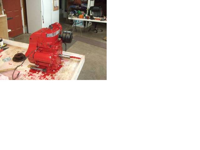

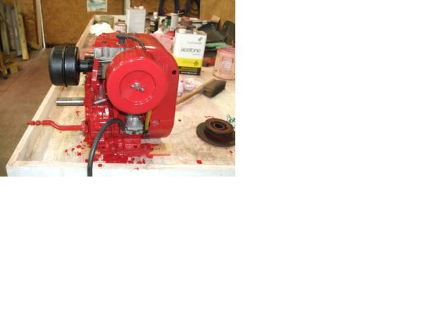

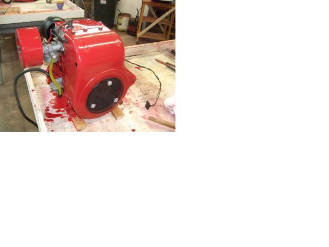

donamy99 14 #1 Posted February 19, 2012 Got my motor back today. Less than I thought-$300. Preping motor for paint. Decided not to paint fins on motor, because of heat and cooling effect. Hope I'm right. Any feed back would be appreciated. Thanks Don Share this post Link to post Share on other sites
jay in nc 211 #2 Posted February 19, 2012 i would paint it. i have a n.o.s. hh120 tecky and it is all white painted. just dont lay it on the fins too heavy. $ 300 for a shop rebuild ,good deal! jay Share this post Link to post Share on other sites
can whlvr 994 #3 Posted February 19, 2012 ya 300 is good,what did they do to it?i put more that 300 into a 12hp and had to do the assembly ,and thats aftermarket parts Share this post Link to post Share on other sites

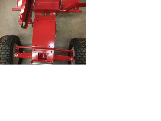

donamy99 14 #6 Posted February 19, 2012 new piston, grind valves, rebuild carb, hone cyl., checked chargeing system. New question--- the plate the engine sets on has four holes, two on each side. One side the holes are 1 1/2" form side, the other holes are 1 1/4" from side, Mounting the engine, WHICH SIDE GOES TO THE OUT SIDE SO THE DRIVE BELT WILL LINEUP? I hope i'm asking this right. Share this post Link to post Share on other sites
Irv 115 #7 Posted February 19, 2012 You might be able to put the model # in the "toro parts master viewer" and see it in a drawing. Share this post Link to post Share on other sites
Martin 2,134 #8 Posted February 19, 2012 i could be wrong, but from your pic i think it might go the other way. does the flywheel side hang down past the bottom of the oilpan at all? just looked again at your picks and its hard to tell on the flywheel side if this is the case. you could just mount it as is and get a long straight edge and see if the drive pulleys all line up. somebody with more experience may chime in with a definite answer for you too......... Share this post Link to post Share on other sites
jay in nc 211 #9 Posted February 19, 2012 don , ijust got back from walking opal & mesuring my raider. the 1 & a half in holes are on the left side when sitting on the seat. jay Share this post Link to post Share on other sites
