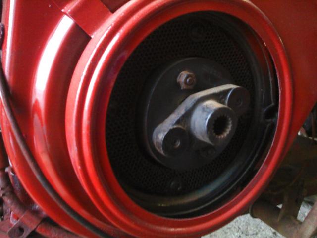

HorseWhisperer 243 #1 Posted February 18, 2012 I roped a new horse to the stall today and found an odd gear attached to the flywheels.I believe its a 64 1055 6 speed.Can anyone tell me more about this flywheels bracket mount Ptolemy? Pto that is.auto spell keeps getting me! Share this post Link to post Share on other sites

TT-(Moderator) 1,170 #3 Posted February 18, 2012 :WRS: "64 1055 6 speed" is an invalid combination. Any possible way of getting pictures posted here will be a huge help, and knowing exactly what you have will certainly help all of us - including yourself. Share this post Link to post Share on other sites

HorseWhisperer 243 #6 Posted February 18, 2012 Flywheels pulley gear?looks like the output driveshaft connector on an old Bolens Share this post Link to post Share on other sites
HorseWhisperer 243 #7 Posted February 18, 2012 67 12 horse with a 241 motor in it with this splined flywheel output coupler.Factory?What did it power? Share this post Link to post Share on other sites
TT-(Moderator) 1,170 #8 Posted February 18, 2012 It's not factory Wheel Horse - and it's hard to tell why it's there. What are the numbers on the engine tag? (model / spec / serial) Share this post Link to post Share on other sites
HorseWhisperer 243 #9 Posted February 18, 2012 The gentleman I purchased it from said it runs a front mounted buzzsaw.He was also under the impression it was a ten fifty five too.The mesh debris screen is factory looking where this pto sits in it.as it is a 67 chassis with a K241 ten horse I think it may be a little "Frankenstein"Serial # will be up momentarily as I must trudge back to the barn and seperated these girls,they get jealous with new arrivals ya know. Share this post Link to post Share on other sites
HorseWhisperer 243 #10 Posted February 18, 2012 The pto gear in question reads lord Erie Pa.model 241 motor isB16495 spec # 46264D Share this post Link to post Share on other sites
TT-(Moderator) 1,170 #11 Posted February 18, 2012 The engine was built in 1966 for Jacobsen - quite possibly for a Chief garden tractor. The only way to know what the coupler is off of and why it's there is to talk to who installed it. I have seen similar set-ups used to drive a hydraulic pump on turf equipment, but nothing exactly the same as this one. :confusion-shrug: Share this post Link to post Share on other sites
