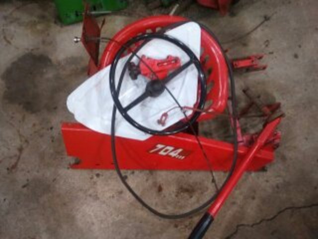

mcgranesp 1 #7 Posted February 18, 2012 I wanted to get a old tractor to restore with grandson. I found this, and just had to have it. it ran and drove good just didnt care for the "brush" paint job. Here is some pics of where im at with it. will update at a later date with any progress. Thank you to all that have helped with info. I REALLY do appreciate it. 1 Share this post Link to post Share on other sites
squonk 46,133 #8 Posted February 18, 2012 Get a hydraulic lift table. 704's fit on them nice! 1 Share this post Link to post Share on other sites
mcgranesp 1 #9 Posted February 18, 2012 Ok went today to TSC and bought a bronze bushing for the steering column. Perfect. $2.79. The bushing was a 3/4x7/8 x 1-1/8x3/4. part # 3284700. Thank you for the information and all your opinions. Greatley appreciated. Does anybody happen to know what the seat is off of that is on the tractor in the first pic ? it is cast iron. I purchased an original square pan seat for it allready. Also i will be looking for the mounting bolts for the hood if anyone knows where i can find them. Also will be looking for a steering wheel center cap. not exactley sure what the original is suppose to be. Thank you. Share this post Link to post Share on other sites
