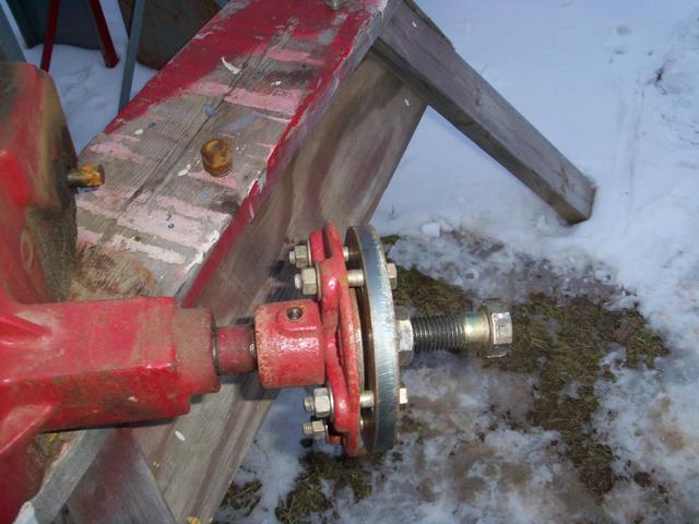

can whlvr 994 #1 Posted February 13, 2012 here is a pic of my home made hub puller,as you can see its fairly simple but effective Share this post Link to post Share on other sites
AMC RULES 37,259 #2 Posted February 13, 2012 Ahh, I wondered what that looked like, nice and simple. Thanks for sharing. :text-datsphatyo: Share this post Link to post Share on other sites
dclarke 4,270 #3 Posted February 13, 2012 Good idea Don, I may have to make one of those. :thanks: Share this post Link to post Share on other sites

can whlvr 994 #8 Posted February 13, 2012 i wish i had an old hub when i made this,woula saved some time making this one Share this post Link to post Share on other sites

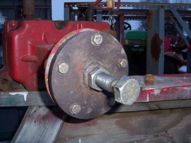

Kelly 1,038 #9 Posted February 14, 2012 This is one I built a few years ago, 1/2" plate lazer cut with a 7/8" nut welded on it, and a 7/8" grade 8 bolt, I use 3/8" grade 8 bolts and nuts, so I don't pull any threads out of the bolt holes, I use a 1/2" drive impact to remove them, sometimes I have to heat the hub, but never had one not come off. Share this post Link to post Share on other sites
bowtiebutler956 650 #10 Posted February 14, 2012 Sure wish I would of had one of these when I was rebiulding my B-80, one of my axle hubs was out farther than the other on mine, so I decided I would loosen the set screws and smack it in a little further with a hammer, bad idea, all I accomplished was to smack it and watch the axle on the other side come out of the trans and land on the floor. I had to tear the whole thing apart just to reinstall the clip. I have to make one of these in the future. Great Idea! Share this post Link to post Share on other sites
can whlvr 994 #11 Posted February 14, 2012 thats a nice neat lookin puller kelly,i didnt want to cut mine,lazy but then i realized it wasnt needed,i use heat also for the tough ones ,and yes to the grade 8 bolts, Share this post Link to post Share on other sites
