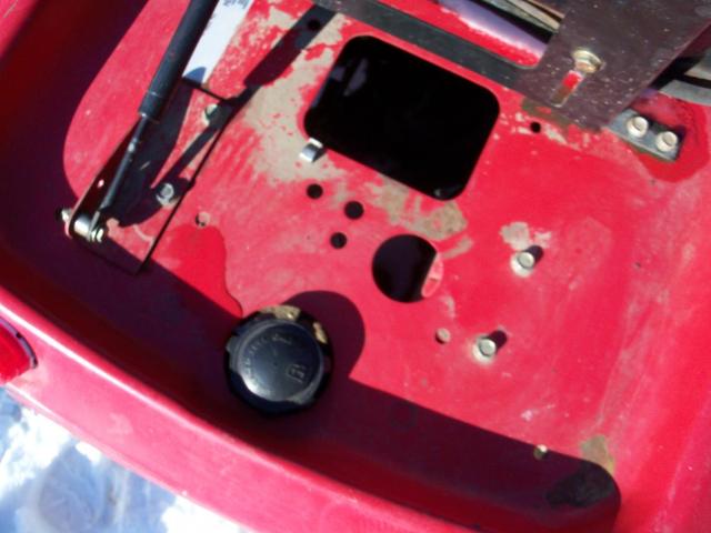

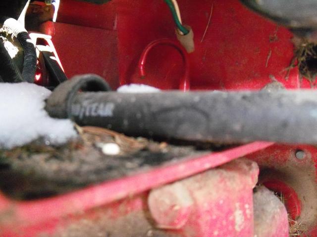

Kelly 1,028 #9 Posted February 12, 2012 Ok here is pics of my 95 314 8 speed, see the round hole on the right of the pic, look straight down in the dip stick should be there, now on this tractor the dip stick is only about 1" out of the top of the trans, my older 310 the dip stick comes up to the fender pan, I took a pic of the 314 from under the gas tank, this is not a easy dip stick to get to, and it was partly covered with grass. Share this post Link to post Share on other sites
