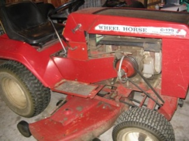

fuzzy 0 #9 Posted February 8, 2012 Thanks for all the replies. I'll have to check on the number when I get home. Here is a small pic. It is a hydro. My grandfather bought this thing new a LONG time ago and it has been used to mow my grandmother's 2 acre lawn. That's all the work it has ever done. I can remember him using this thing when I was just a youngun and I'm 37 now, so it's gotta be at least 30 years old I would think. I know the engine was replaced a while back, probably 10 years ago. I love this tractor and know we have not begun to use it to it's potential. I just recently started looking into buying a small tractor for our 90 acre farm to help with plowing the garden, hauling firewood, and the like, but I just simply can't afford it. So I thought, why not try to use the old wheel horse. I found some information on the clevis hitch (which we have) and have been thinking about getting a Brinley plow for this year's garden tilling. However, right now it's firewood season and I need to stock up for next year! Again, thanks for the welcome! Share this post Link to post Share on other sites

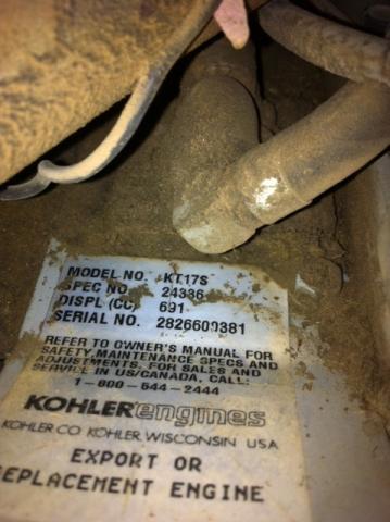

Don1977 606 #15 Posted February 8, 2012 You said that the engine has been changed, does the engine on the tractor now have an oil filter. If so you have a Series II engine with an oil pump. Looking at the front of the engine the oil filter would be on the right side. Share this post Link to post Share on other sites

Sparky-(Admin) 26,270 #20 Posted February 9, 2012 I can remember him using this thing when I was just a youngun and I'm 37 now, so it's gotta be at least 30 years old I would think. Heres the model #'s for your machine. Its somewhere in the 1980-1984 range. 01-17KS01 =1980 (EARLY 1980 with a Sundtrand hydro) 01-17KE01 =1980 (LATE 1980) or 1981 with an eaton 1100 hydro 01-17KE02 =1982 01-17KE03 =1983 11-17KE01 = 1984 Share this post Link to post Share on other sites

fuzzy 0 #23 Posted February 9, 2012 Wow, you guys are full of great ideas! Thanks! Here is a photo of the engine label, don't know what all of it means, but here it is. My dad has already fabricated a pretty nice hitch for it to pull his leaf vacuum with, and I already have a pretty nice JD trailer that hooks up nicely to the tractor. I just need to take the deck off and go pull wood I guess. I'll give it a try with the turf tires and see how it goes. Thanks again, Chris Share this post Link to post Share on other sites
pfrederi 21,101 #24 Posted February 9, 2012 That is a replacement engine and it is a series 2 which is a very good engine with a good oiling system. If my L107 can haul 750 lbs of coal you should do real well with your firewood 2 Share this post Link to post Share on other sites
