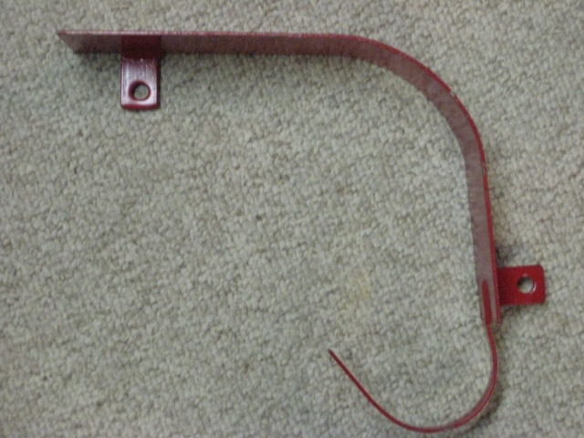

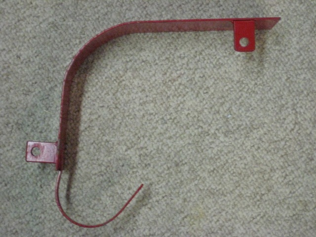

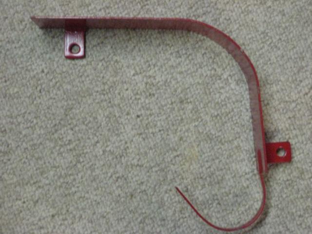

VinsRJ 724 #9 Posted February 8, 2012 Here are some pics of my NOS belt guard. 1 Share this post Link to post Share on other sites

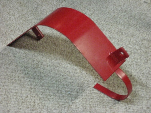

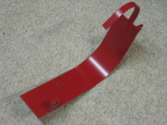

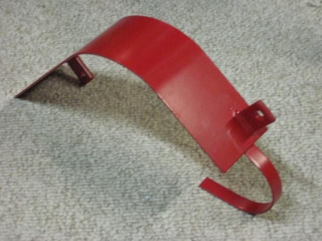

jeremi3210 759 #15 Posted February 19, 2012 Here are pics of my homemade belt guard thanks again for all the help!!! turned out pretty good i think. Share this post Link to post Share on other sites
VinsRJ 724 #16 Posted February 19, 2012 That looks perfect! One of the great things about these early WH's is that you can repair them with everyday tools and materials. Share this post Link to post Share on other sites
