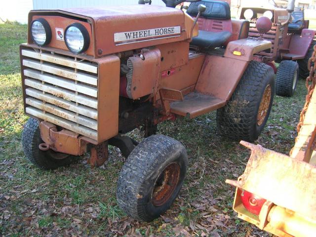

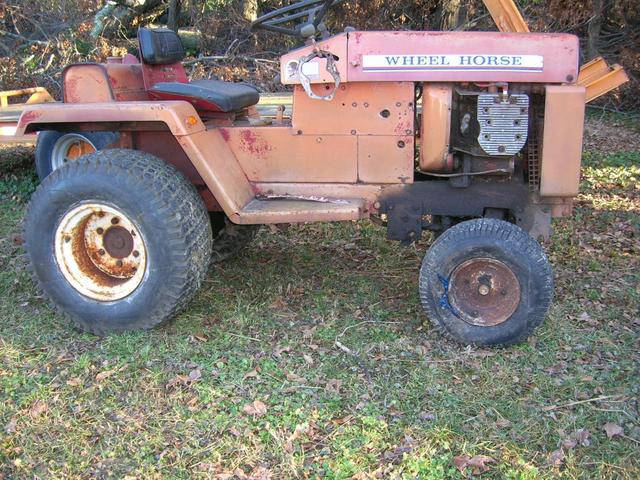

couple pics of my 18 auto
73-18 automatic
one more
I think mine has the same rod broke

Looks pretty complete. Nice find. Do either of your D-series have an engine shroud on the right side cylinder? As Bob pointed out above, mine appears to be missing.

My D160 has an onan but the new to me 18 auto is missing that shroud (maybe thats why it broke the rod)

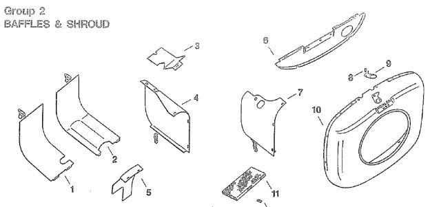

Here's a pic of the shrouds that are on my 482. This is from the Kohler Parts manual for the 482/582 Twins.....
1 and 2 are the bottom cylinder shrouds.....4 and 7 are the head shrouds......3 and 5 fit beside the governor and vacuum / fuel pump area.....5 and 10 are the flywheel shrouds. There are some other tins listed but must be for other applications.
