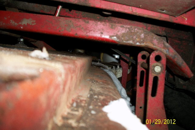

dcgrealtor 2 #1 Posted February 6, 2012 I have a 1972 Charger that I just bought. I noticed the rear of the mower is not attached to anything. There is an arm that rotates down (The height lever) is this suppposed to be attached to the pin that shows in the picture? Share this post Link to post Share on other sites
Raider10 3 #2 Posted February 6, 2012 I think that there is a rod fastened to the lift lever which drops down and attatches to the middle of the deck Thats how it was on my raider 10 when i got it. Nothing attaches to the rear. It simply hangs from the lift lever and pivots on the tacamatic thingy. Hope this is of some help. Ian :ychain: Share this post Link to post Share on other sites
dcgrealtor 2 #3 Posted February 6, 2012 Thanks for the reply. Mine is a Charger 12 I do not know if that makes a difference. It is only attached towards the front. Why do you suppose this connection with pin is on the rear of the mower? Would you not think that this should be attached to something on the Tractor? Confused!! Share this post Link to post Share on other sites
