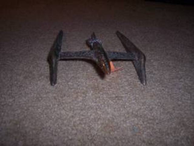

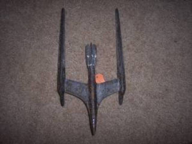

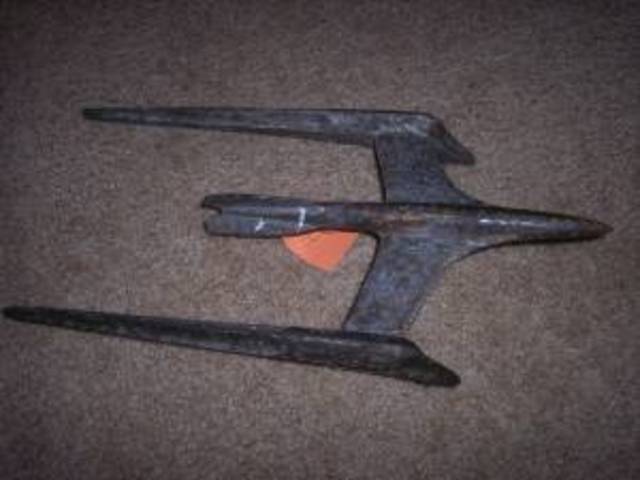

Mykol610 2 #3 Posted February 4, 2012 It didn't look like chrome. Unless it was extremely worn. It was dark like steel or aluminum (I almost want to say aluminum cause it's not rusty...). I could feel this pitting on it. It was pretty deep. Almost like someone shot it with really small BBs. Here's a few pics from the Craigslist ad. It's dark and seems worn but not rusty. Share this post Link to post Share on other sites
rmaynard 16,837 #4 Posted February 4, 2012 That hood ornament was chrome plated pot metal. It doesn't really rust, but it does corrode and pit when the chrome starts to degrade from weather. If you want to get it back to new looking, you will have to have it bead-blasted and re-chromed. Otherwise, a good sanding and some paint will freshen it up Share this post Link to post Share on other sites
