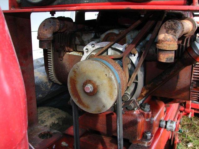

slufoot733 70 #27 Posted February 13, 2012 OK, I finally received my mufflers. First off the quality isn't that great. One had the inlet pipe welded at an angle which right off the bat caused a problem. That is not the venders fault since he didn't make them (but I would have inspected the product a little more closely and NOT sent out a part like that). Secondly, the 1-3/8" inlet had to be opened up a little by pounding a piece of pipe into it. The very rim of the inlet pipe curved inward ever so slightly and would not slip over the exhaust pipe. Third, the outlet is not as long as I hoped it would be. I will have to get an extension. I had both mufflers installed in about an hour and a half. Here's a shot before I started but without the original mufflers I had a bugger of a time removing the elbows cause they have been there forever. Here's a shot after I had them both installed. The dent in the upper right is my fault. I had to pound the mufflers onto the pipe. I used a piece of wood as a cushion against the muffler but I managed to dent one a little. These next two shots show the top and bottom of the mufflers. The top is solid against the grill frame. I may remove them and flatten the muffler top a little to give some non-contact clearance. The bottom shows the outlet pipe is short. I was planning to get a couple 90 degree turnouts anyway so I'll get some that will fit. After I was done I started the engine and let it idle for about 10 minutes. The paint on the mufflers stinks pretty bad so I can't wait for it to burn off. They are not as quiet as I had hoped for but way better than none. I'm sure there are better mufflers available out there somewhere. I needed them sooner rather than later so I went ahead and got these. I believe they will serve the purpose. If someone is not in a hurry for mufflers I would continue the search. Kevin Share this post Link to post Share on other sites
JamesBe1 84 #28 Posted February 14, 2012 Very nice work Kevin. Nowadays, you have to make do with what you got. I admire your inventiveness. I am curious to see of the top of the muffler lets the grille frame get too hot. Also, I'd like to see how you manage the bottom of the mufflers. All in all, very resourceful work. Share this post Link to post Share on other sites
slufoot733 70 #29 Posted February 14, 2012 Thanks James. I'm concerned about the heat issue also. Might not be a problem in the winter but come summer it could be very hot. I will definately do something about it. I have to check around on the outlet extensions. First stop will be my local muffler show to see if they have pipe small enough and can bend it for me. I'll post pics when I get something. Share this post Link to post Share on other sites

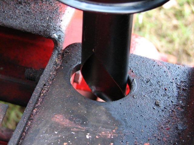

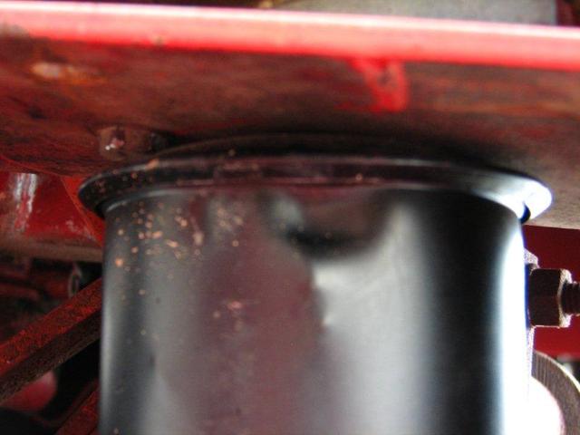

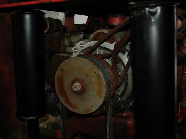

JamesBe1 84 #50 Posted May 18, 2012 Well, it seems that Walker is now in the business of selling Stanley mufflers. Summit Racing had Walker drop ship the mufflers directly to me. As soon as I saw the boxes, I knew something was amiss. I opened the boxes, and there were the same type of mufflers as before complete with the Stanley name embossed on the side of them. ****! I guess I'm going to try to run these as stacks. I spent the evening putting on the FEL to see is there is enough clearance. I don't have any hydraulics hooked up, so I am unable to raise the FEL to see if it might hit anything. But with the FEL in the down position (I don't have the bucket attached), there might be enough room, but the right side might be a bit tight. Since I have two mufflers, I might as well run stacks on either side. The left side looks like it won't be much of a problem. Anybody got any good pics of how they ran their pipes in a stack configuration? Share this post Link to post Share on other sites
