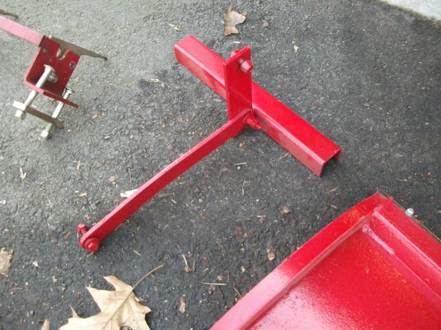

Sparky-(Admin) 19,572 #1 Posted January 22, 2012 Picked up a 48" plow to upgrade one of my machines with a 42" plow. The new plow had been used on a 520 before and came with the extension bracket and a lifting thingy. Are these the only two parts of the 520 extension kit? Not sure if I want to keep em on a shelf in case I ever get a 520 or sell them, but I need to know if I have all the parts. Heres a couple pics of the parts. Mike............. Share this post Link to post Share on other sites
Rollerman 290 #2 Posted January 22, 2012 Thats it Mike, good find. :handgestures-thumbup: Share this post Link to post Share on other sites
Kelly 1,028 #3 Posted January 22, 2012 The angle handle is diff. for the 520 kit, it is angled back to clear the PTO bell and so you don't have to reach so far forward, but those parts are the main pieces you have. Oh the long flat bar is the solid lift link, so you can have down pressure, it can be used with the blade with out the 520 kit, I love having down pressure with a hyd. lift tractor, it makes back blading nice, I can lift the front tires about a 1" off the ground on my 520, and pull the blade backwards to clean in the driveway around the flower boxes. Share this post Link to post Share on other sites
