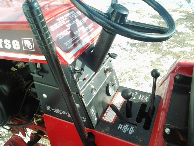

CTPATRIOT 12 #5 Posted January 22, 2012 Thanks for the info Kelly.Are the parts easy to install?I'd like to get them sometime.Just took a pic of my dash,no adjuster! Share this post Link to post Share on other sites

Wyattrrp 59 #11 Posted January 23, 2012 CT Funny that your dash photo above shows your vertical panel has the "Down / Lift / Up" arrow decal for the adjuster, where the adjuster knob should be. My '90 312-8 has the adjuster, as does my '81 C-125-8 Share this post Link to post Share on other sites

Duff 207 #15 Posted January 23, 2012 CT Funny that your dash photo above shows your vertical panel has the "Down / Lift / Up" arrow decal for the adjuster, where the adjuster knob should be. My '90 312-8 has the adjuster, as does my '81 C-125-8 I think the decal you're looking at is actually for the implement lift handle and is standard on all manual lift 300-400 series tractors, but I could be wrong...sure wouldn't be the first time! Duff :thumbs: Share this post Link to post Share on other sites
Wyattrrp 59 #16 Posted January 24, 2012 DUH....Duff I never really paid attention to what that decal was referencing since it was half hidden behind the knob for the attachment height adjuster so I Just assumed it was for the knob. Your reply makes sense now. I always assumed that adjustment was standard equip with the C series and after on the 300 400 since both mine had them. I ordered my '81 new back then and it arrived several weeks later, without any special order of an option for the adjuster. My dealer must'veordered it with it or the C series came on it. My manual shows it with no Option reference? Live 'n learn. Thanks for the common sense answer. Wyatt Share this post Link to post Share on other sites

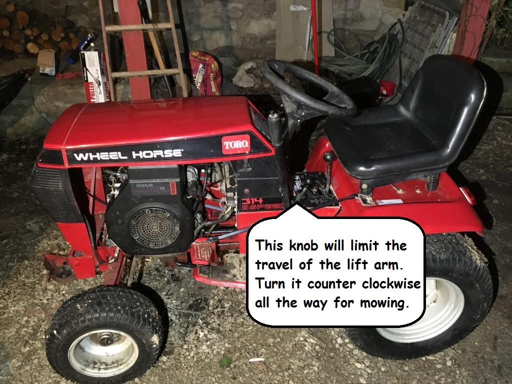

Mrr919 0 #19 Posted November 5, 2019 I have a 310-8 and am looking for this. Does anyone know if these parts are still available? Share this post Link to post Share on other sites
953 nut 69,133 #20 Posted November 5, 2019 26 minutes ago, Mrr919 said: I have a 310-8 and am looking for this. Does anyone know if these parts are still available? If the part shown in this photo is what you are looking for you could contact Lincoln at @A-Z Tractor https://a-ztractor.com/ 1 Share this post Link to post Share on other sites
