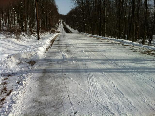

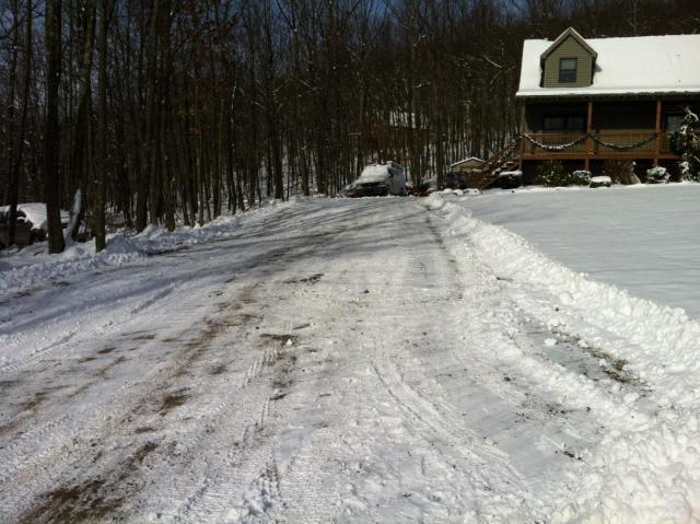

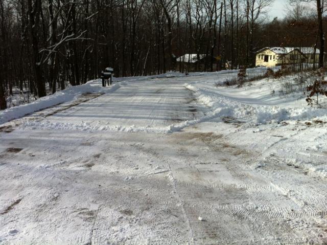

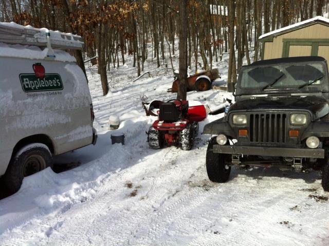

Hodge71 691 #18 Posted January 22, 2012 Heres some after pics of my drive and road too. Took me about and hour and a half but I must say this thing pushes snow awesome!!!! Share this post Link to post Share on other sites
Kelly 1,039 #19 Posted January 22, 2012 You plowed that WHOLE road in the first pic? your nuts buy a beater truck with a plow, I like plowing with my tractors, but there is a point I would have to say no. Share this post Link to post Share on other sites
Sparky-(Admin) 26,890 #20 Posted January 22, 2012 I think he only cleared the driveway Kelly, just showed the road to show how much snow fell. Thats what I think anyway. Mike............. Share this post Link to post Share on other sites
Rollerman 291 #21 Posted January 22, 2012 Stephen, I know there are definite gearing differences as the D's have a top speed of 7.3f and 3.0r and the C is around 6.3f and 2.5r. How would the pump from a C work on a D? I'm just lost as to how the swash plates could interchange. Gear ratio should be controlled by the hydro motor internals. Am I correct in assuming this? I guess maybe I will understand more once I see my stuff tomorrow. Jeff you pulled your D160 hydro motor off the trans case right? The gearing between the motor & the trans is lower on the D's (& GT 14's) on account of the taller rubber. Don't give up on the D yet, you may want to keep your eyes out for a parts machine. IMOP with a D....you really need a parts unit too. Parts are just not as common as the smaller Horses. Good job on the plowing :text-coolphotos: Share this post Link to post Share on other sites
Hodge71 691 #22 Posted January 22, 2012 Kelly, I guess I'm nuts. I did plow the whole road and my driveway. My iPhone makes the pics look a whole lot worse than it is, more panoramic I guess. Its really only about 20 feet wide and 1/8 mile long. The section in front of my house is paved, the section around the bend isn't. That was the whole reason I wanted this 18 auto in the first place, I plow quite a bit. I am actually going a set of bolt on "ears" for this plow like the full size plows have to keep the pile in front of it a bit more. It will be just shy of 66" when I'm done. Rollerman, This was a parts machine to start with, The problem is I didnt know that when I bought it. I should have spent more time researching a real operating D. I wouldnt be in this position. Hindsight is always 20/20 and I was in this thing for the long haul. Then I saw how my 416 pushed the snow. Its a shame, the 18 auto itself isnt bad other than rust, dents etc. from the abuse its seen. The hydro was the only problem so far that has the potential cost me a ton of cash. Unfortunately I didnt think it was that bad until after I tore the tractor down to the engine and frame to repaint it all. I should have found out how bad the hydro was before I sunk all this time and money into bodywork and paint. Experience is what you get right after you need it...... Share this post Link to post Share on other sites
