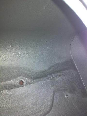

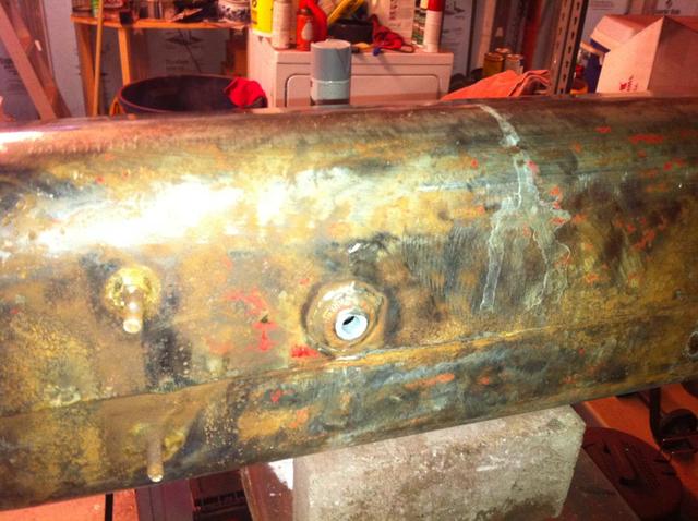

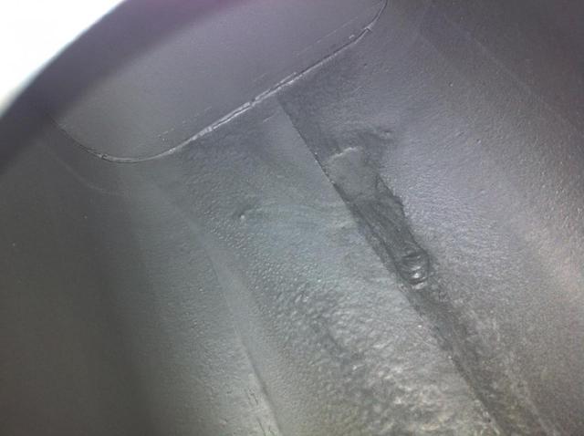

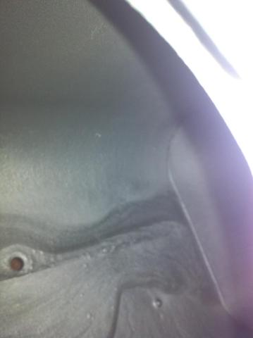

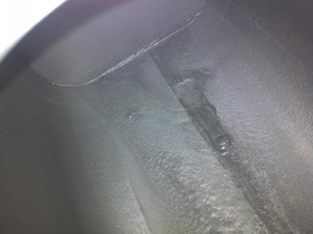

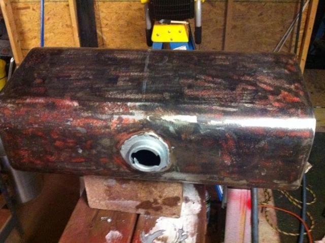

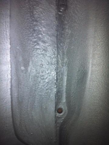

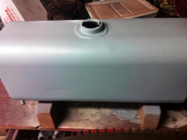

Hodge71 691 #10 Posted January 14, 2012 Ok guys here the pics that were requested and hopefully answers to some of the questions asked. I cleaned the inside of my tank by first putting about 1 foot of chain into the tank throught the fill hole. I then strapped it to my 416 tire with a few bungee cords and drove around for awhile to loosen all the rust in it. As you might remember my fuel looked like chocolate milk when this whole process started. After doing the chain thing I followed Por 15 instructions and rinsed the tank with soapy water and the adding the Por 15 Marine clean and sloshing the tank all over for about 15 minutes and then leaving it sit on each side for 20 minutes to allow it to dissolve the varnish and crud from the gas. After that it gets rinsed well and the whole process starts over again with Por 15 metal prep acid 20 minutes of sloshing and then sitting on each side of the tank for 30 minutes. This process is where the rust inside is all dissolved and it became quite obvious to me at this time that I owned a seive...not a gas tank. Almost 2 hours later, dumped acid and washed with water til clear and no longer bubbly. I couldnt believe how the inside of my tank looked. It was absolutely rust free and silver metal inside. It needs to dry completely or the sealer will not stick. I accomplished this by having my ceramic heater blowing on the outside and my heat gun blowing hot air into the tank thropugh the fill for 24 hours straight. After that the Por 15 sealer gets mixed thoruoghly and dumped in throught the fill neckand gas cap put on. Slow roll the tank to thoroughly coat everything I also let it sit on each side for aout 10 minutes to be sure all seams were covered. Then you stand the tank straight with the petcock hole in the bottom, I had a wooden dowel in the hole to keep the sealer inside. I pulled the dowel out and drained the remaining sealer into the container it came in. Heres the pics of the tank inside now Dave As far as your tank...there is hope!!! The first thing I would do is get the Por 15 kit specifically made for tanks that had an inferior sealer used. It has a vicious liquid stripper included to dissolve the old coating and then everything to seal it the right way. Its called the "Heavy Duty Motorcycle Tank Repair Kit" and sells for $48.25 on their website. As for me, you can see its primed, now starts the sanding process. Hopefully the hi build primer and tons of sanding will fill all the pits on the outside of this thing and get me a smooth surface to paint. Share this post Link to post Share on other sites

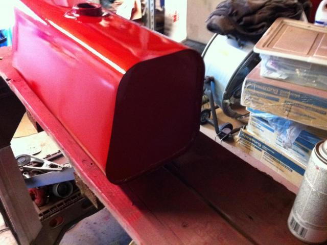

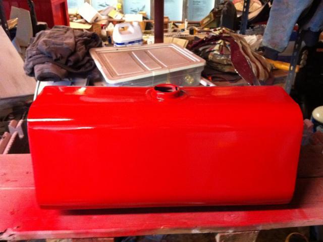

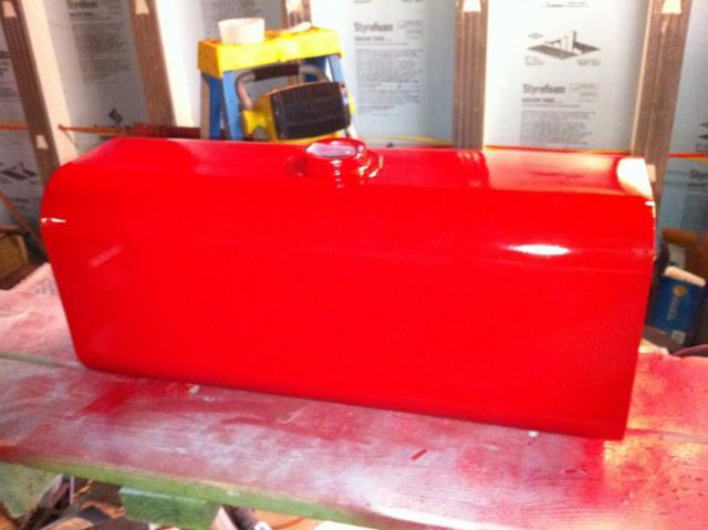

Hodge71 691 #11 Posted January 15, 2012 Heres the after pics. I must say it came out pretty ok Share this post Link to post Share on other sites
Kelly 1,038 #12 Posted January 15, 2012 Looks good, just let the sealer dry a week or so, the puddles will not cure like the rest, and gas will eat it, but when dry it's a rock. Share this post Link to post Share on other sites
Pollack Pete 2,273 #13 Posted January 15, 2012 Hey.......REAL nice job on that tank.Don't ya love it when you can start out with a rusty mess and turn it into something like that? Keep up the good work.Guys like you keep me motivated to get some tractors done. Share this post Link to post Share on other sites
