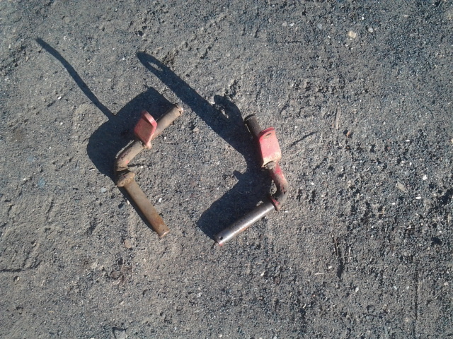

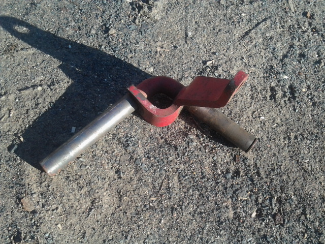

CTPATRIOT 12 #11 Posted January 16, 2012 Well after some digging around in my parts bin i found these spindles,and one front wheel!I only have one of the heavy duty spindles,i believe it's from a C160?Are they hard to come by?I'd like to get the other side also. Share this post Link to post Share on other sites
kpinnc 18,916 #12 Posted January 16, 2012 Does the steering feel any different with the bigger fronts? Contrary to what some have said- It does make a difference. My 310-8 steers much easier with 8-inch wheels and tires up front. The tires are what make the difference. Most 6-inch tires have a pretty "high profile" (taller) sidewall, and it rolls under on a tight turn. 8-inch tires tend to be smaller in sidewall profile and just a bit more rigid on turns. Obviously, the rolling resistance is lower on a larger wheel as well. Also, I kept the taller spindles on my tractor and it made no difference in the way the tractor works and mows. The front is about 3/4 of an inch higher than normal, which is nothing. Since you are using a 42-inch deck, you'll have no clearance issues either. As has been said, only the 37SD has issues. Share this post Link to post Share on other sites
