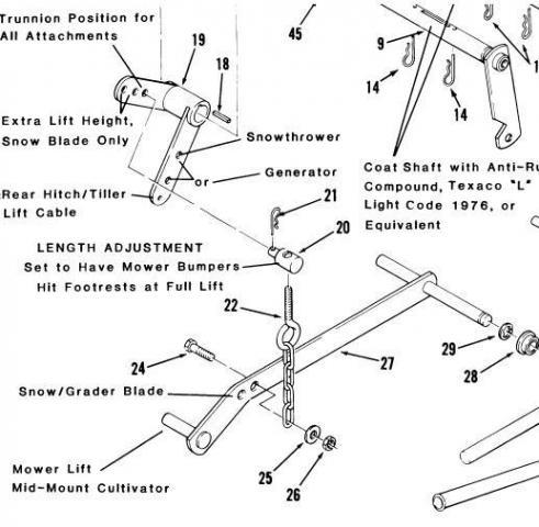

JFS 0 #1 Posted January 10, 2012 I just picked this up on Sunday and want to mount it on my 1990 416H. The book doesn't show a very good picture of the lift arm mounting does it mount in the hole just behind where the mower deck was removed from? Thanks Jim Share this post Link to post Share on other sites
Hydro 130 #2 Posted January 10, 2012 Are you talking about this? Share this post Link to post Share on other sites
JFS 0 #3 Posted January 10, 2012 Yes this is what I was wondering. I use that hole next to the chain for my snow blades but do I put the snowblower lift arm in that hole also? Thanks Jim Share this post Link to post Share on other sites
Hydro 130 #4 Posted January 11, 2012 Connect to the lower one where it shows as a generator Share this post Link to post Share on other sites
