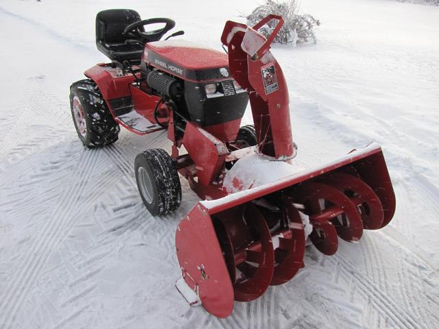

Hydro 131 #1 Posted January 6, 2012 I have had several emails from R/S members who have asked me about my front tires. For what I am using them for they are great. As most know, the 44" 2 stage is very heavy outfront. I have these tires inflated to 25 psi and the tractor steers easily. They also help it to track and if it starts to slip I just raise the blower a hair and it recovers right away. I have only used turf tires before and this is my first experience with Vredesteins. They were purchased used but in new condition. Share this post Link to post Share on other sites

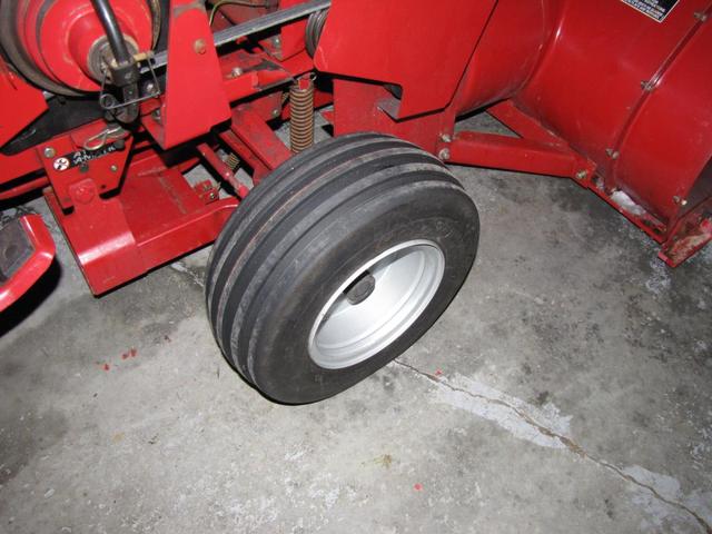

Hydro 131 #7 Posted January 6, 2012 Forest Road formerly known as Cole's Dad gave me an idea before I bought these tires of using #40 chain running around the outside of the tire to make steering easier. I thought that was a super idea but it's not necessary with this tread pattern. It could be easily done though and each length would stay inside the rib where it was placed. Here is the real McKoy Share this post Link to post Share on other sites

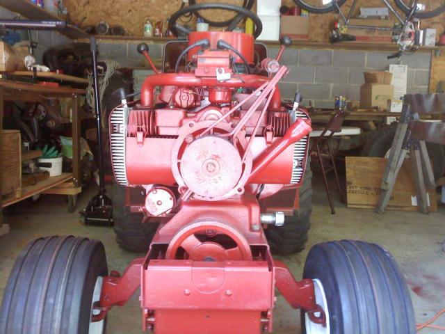

Trouty56 568 #9 Posted January 6, 2012 I have those 5 ribs on the front of my D-180. Makes steering that big guy much easier. Got mine at Tires of Queens or something like that. Best shot I got of them...man...I got to take more pics..... Looked it up it is...(see below) ......no website I could find. I called them on the phone (when I got them) 140 bucks a pair free shipping for 18/8.5 X 8's. It was my first big purchase 2 yrs ago for the D series. The Tire Place of Queens Limited 6976 75th St Middle Village, NY 11379 718-894-8473 Share this post Link to post Share on other sites
