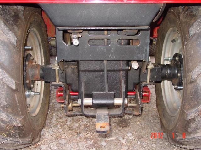

shallowwatersailor 3,213 #15 Posted January 7, 2012 Still no snow, none in the forecast, and low 60s for today! Scott, here are a few quick pictures of my 518xi and the 1st hitch that I bought from you lined up together. I meant to do this before I mounted it on my C-105 but not even five minutes and it was off. I'm pulling my tires off the 518xi ( good time to put the lug bolt conversion on that I bought from Bob Maynard last summer) as well to get the side view. That way I can size it up better for you and take some better shots. It appears that the four bolts that hold the transaxle may be a problem as they are low to the axle housing; and the carriage bolts for the rear Attach-A-Matic are right there as well. Perhaps a U-Channel in place of the Angle and then trimmed to clear? By the way, I would like one as well besides brrly1. Share this post Link to post Share on other sites

smoreau 658 #17 Posted January 7, 2012 Still no snow, none in the forecast, and low 60s for today! Scott, here are a few quick pictures of my 518xi and the 1st hitch that I bought from you lined up together. I meant to do this before I mounted it on my C-105 but not even five minutes and it was off. I'm pulling my tires off the 518xi ( good time to put the lug bolt conversion on that I bought from Bob Maynard last summer) as well to get the side view. That way I can size it up better for you and take some better shots. It appears that the four bolts that hold the transaxle may be a problem as they are low to the axle housing; and the carriage bolts for the rear Attach-A-Matic are right there as well. Perhaps a U-Channel in place of the Angle and then trimmed to clear? By the way, I would like one as well besides brrly1. I can make one to fit that, just reverse the angle iron and make the hitch a little wider and the hitch will have to stick out another 1" This should not be a problem to build at all and would not be a problem for me make the modifications needed for you guys. I will send you both pm's 1 Share this post Link to post Share on other sites

Brrly1 1,146 #21 Posted January 9, 2012 Scott, looks like you beat me to it. I'll go ahead and post. They look quite similar. Share this post Link to post Share on other sites
