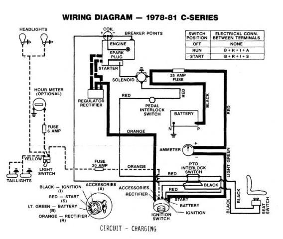

rmaynard 17,634 #6 Posted January 3, 2012 Looks like my rectifier/regulator is bad. How do you know that it is bad? Did you check to see what the AC voltage is coming from the stator? What is the DC voltage coming from the B+ terminal of the regulator/rectifier? As Don said, make sure the regulator/rectifier is properly grounded. A bad ground can cause over-voltage as well as other symptoms. Before assuming that you have a bad R/R, check all connectors in the charging circuit. Here is the wiring diagram for the charging circuit. Share this post Link to post Share on other sites
