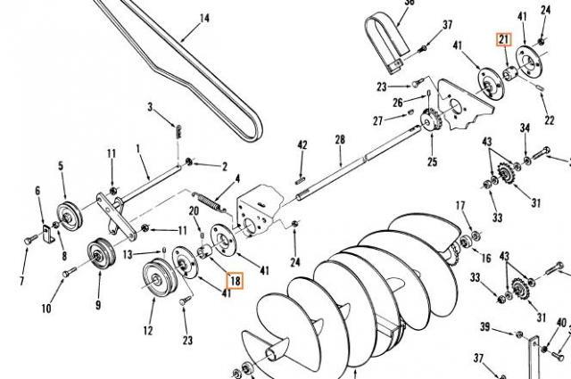

rmaynard 17,527 #1 Posted January 1, 2012 Has anyone sourced bearings, other than Toro, for the input shaft of a 06-42ST01 snow thrower? I am referring to items number 18 and 21 in the picture below. Also item number 31, the idler sprockets, seem to be in abundance in a 17 tooth version. Mine are 18 tooth. Is there any problem in replacing an 18T with a 17T as long as it is the right pitch? Share this post Link to post Share on other sites

rmaynard 17,527 #4 Posted January 1, 2012 The problem with bearing number 21 is that it is a self-centering insert bearing with a 1/4" roll pin affixing it to the shaft. Having scoured the bearings at TSC, they have one that is close, but just like all of the insert bearings that I have found on the internet, they have the wrong dimensions to fit into the mounting flanges, and none have the holes for a pin, only set screws. TSC's are 47mm OD, and the OEM bearings are 52mm. Share this post Link to post Share on other sites
