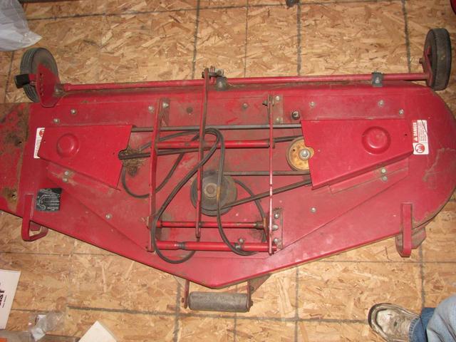

Kelly 1,033 #1 Posted December 30, 2011 I know it's off season, but I picked up a 60" deck today, it's in overall nice shape could use paint, has new blades and came with the correct spring loaded mule drive, my questions are I can't find a model no on it, it is the heavy fabricated style what years did they make that style? 2. it has deck wheels on the front outer front corners but they are not factory, did this style come with rollers on the corners? someone did a very nice job building these roller mounts, and a was a pro at welding. And yes this is for sale if anyone needs a nice 60" deck. Share this post Link to post Share on other sites

Kelly 1,033 #3 Posted December 30, 2011 This looks to have had skids, and someone added the rollers, I'll get pics tomorrow, I took some today but after getting in the house found out I forgot to put the SD card in the camera :banghead: Share this post Link to post Share on other sites

Kelly 1,033 #9 Posted December 30, 2011 Yes just like that one, but has added rollers to the front corners. Share this post Link to post Share on other sites
MalMac 1,332 #10 Posted December 30, 2011 Kelly it should be a C5-60SC03 somewhere 1988 to 1991. The pic is a deck that came on my 1991 520H. If thats Ricks deck it came off a 1989 520HC. Share this post Link to post Share on other sites
Kelly 1,033 #11 Posted December 30, 2011 Yes it was Ricks, and he did say it was off a 520HC Share this post Link to post Share on other sites
Kelly 1,033 #12 Posted December 31, 2011 Here is pics of the deck in question with the added on rollers, and a few pics of the spring loaded mule drive, I was talking to a member here this morning on the phone and he asked to see pics of that. Share this post Link to post Share on other sites
zieg72 209 #13 Posted December 31, 2011 I would willing to bet it is a C5-60SC01 Share this post Link to post Share on other sites
gwest_ca-(File Mod) 11,480 #14 Posted December 31, 2011 Service Assembly 14-4799 adds the anti-scalp rollers to older decks. Parts list, illustrations, modification instructions included in product service bulletin Toro91-presGT #GT04 Anti-Scalp Rollers 60in Mower.pdf Garry Share this post Link to post Share on other sites
