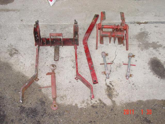

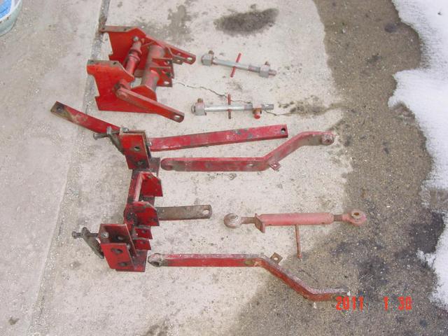

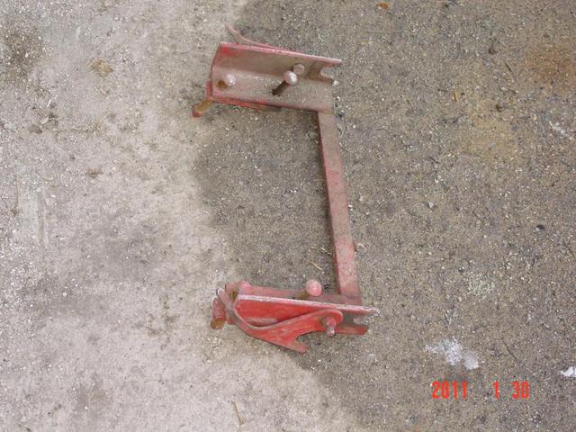

Ok here we go. I am going to post some pictures that I have of the three point that I have for sale
Brrly1
The third picture gets turned around then it fits on the front side of the rear axle which the bolts go thru the piece that holds the lower legs. I don't know if I have a manual or not. If you look at your next to last picture look at the left side and you can see where the lift cylinder would fit if you had the independent three point setup which is actually another lift valve that mounts to the rear fender with an arm that goes to the front part of the tractor that has a bracket which attaches to the tunnel area which in turn gives you the seperate or independent lift. I hope this makes sense. Stand to the left side of the tractor and you should see a3/4 to 1" hole that or should possibly be inline with the normal lift valve. Does this make sense at all?

Here's some pics of my 3pt connecter bar....
refracman
Ya somebody made that bar for sure, cant tell for sure but it looks to be off.The bend is in the wrong place and not enough.

Ok got some measurements and pics of the bar. I have a spare one pm if interested.
bar stock is 5/8 x 2 the bar is 28 1/2 with the bend, the bend is at 16in and 7in from striaght.
also it has a offset of 1 in
dont wory i confused myself to just now but heres the pics and hopefully this will clear it up some.
