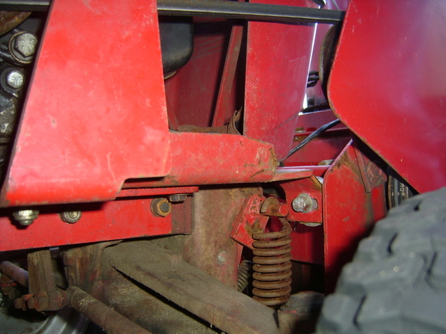

Hydro 131 #7 Posted December 28, 2011 This photo was not taken to answer your question but you can see part of the anti sway bar in place. It slides into the bracket which is mounted to the right front of your frame ahead of the PTO. Share this post Link to post Share on other sites

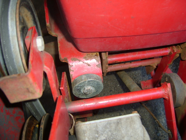

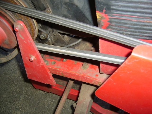

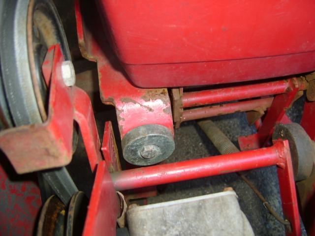

truckin88 104 #8 Posted December 29, 2011 hate to be pain can you look at picture of the hookup of the guard and the anti sway to the frame Share this post Link to post Share on other sites
wallfish 19,400 #9 Posted December 29, 2011 The belt guard, for near the PTO, gets bolted to the frame, the anti-sway bar connects to that, Share this post Link to post Share on other sites
Hydro 131 #10 Posted December 29, 2011 The belt guard bracket front bolt is a bit of a pain to wrench but it does fit. Share this post Link to post Share on other sites
truckin88 104 #11 Posted December 30, 2011 TY for the pics, is the belt guard only one piece? The local dealer thinks he has one. Share this post Link to post Share on other sites

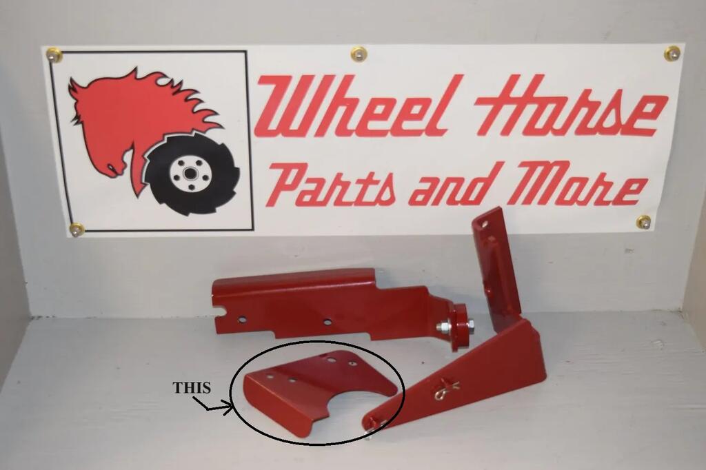

HorseFixer 2,014 #16 Posted November 29, 2023 On 12/29/2011 at 9:42 AM, wallfish said: The belt guard, for near the PTO, gets bolted to the frame, the anti-sway bar connects to that, Thanks John The Pictures really help. I was on the phone talking to Lowell from WHEEL HORSE PARTS AND MORE ans we go on the subject of the Anti Sway Bracket on the two stage blower. And since I am hooked up to a peritoneal dialysis machine for 9 hrs ea night I couldnt go out and ck. So this morning out to the shop I went. Well there wasn't one on the CHUCKER. Sinc e I had a spare blower I was able to rob it off of it. Since this blower has been operating since 2012 without any problems except the hood getting paint rubbed off one would wonder if it is really needed. I do have a question tho. What are the two nubbins show on the bottom picture for? Also Since Lowell sells it as a 3 piece kit what is the small pies for and where does it go? Thanks Duke Share this post Link to post Share on other sites
JCM 10,808 #17 Posted November 29, 2023 The 2 nubbs are for the small belt guard that attaches with 2 small hairpin cotters. @HorseFixer Share this post Link to post Share on other sites
wallfish 19,400 #18 Posted November 29, 2023 5 hours ago, HorseFixer said: What are the two nubbins show on the bottom picture for? Also Since Lowell sells it as a 3 piece kit what is the small pies for and where does it go? I believe they hold another belt guard that is around the PTO but I never had one Not sure what small pies are. Can you post some pics? That belt rub on the hood is about all that anti sway bar is for. Just keeps the thing from being able to sway over that far over Share this post Link to post Share on other sites
HorseFixer 2,014 #19 Posted November 30, 2023 14 hours ago, wallfish said: I believe they hold another belt guard that is around the PTO but I never had one Not sure what small pies are. Can you post some pics? That belt rub on the hood is about all that anti sway bar is for. Just keeps the thing from being able to sway over that far over Sorry John I meant to say piece aka the small part shown in the kit, I believe it is the belt Gard you were talking about. Share this post Link to post Share on other sites
wallfish 19,400 #20 Posted November 30, 2023 17 hours ago, HorseFixer said: piece aka the small part shown in the kit Yup, that's the belt guard that connects to those pins on the triangle part. Think one of the holes lines up to put a nut and bolt on to keep it tight but not sure. Never had that piece It's Part #41 on the IPL https://www.wheelhorseforum.com/search/?q=2 stage blower&quick=1&type=downloads_file Share this post Link to post Share on other sites
