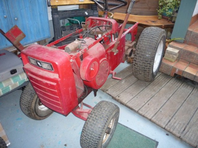

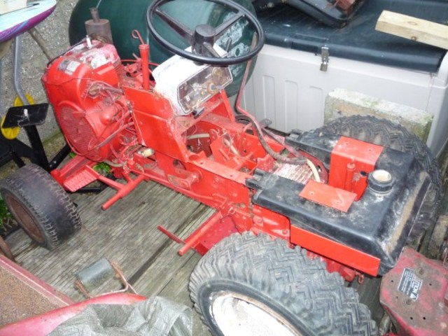

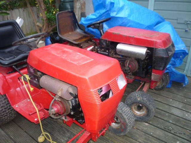

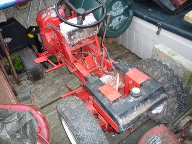

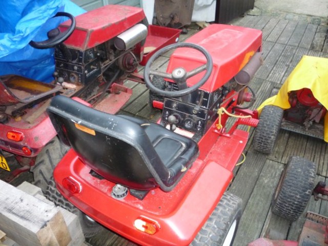

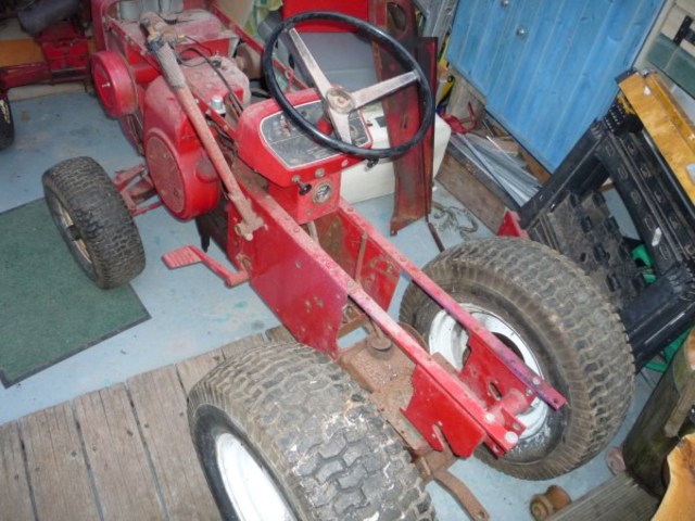

feather20a 3 #1 Posted December 27, 2011 Hello, this is my first post. Last year I rebuilt a JD LX178 and took it to my house in Sweden. This year in the UK I purchased a WH C125. Got it together to use at work for tugging stuff around. Then came across a collection of 6 WH tractors just 500yds from my house in the UK, the collector sadly deceased. Well I took anything that was painted red in the garden! Some impliments and spares. Hooked now. so I need some info on 3 of the tractors as I can't identifiy them. I will endeavour to put photos with this post. Bear with me. This model has no ID plate these models have" Europa 8speed" on the sides. Both with Kohler Magnums. This model 14hp, longer and cast front. (with plastic tank behind -which I need renewing) I think 4 speed gear box. Id plate reads model 1 0502 8 then 917361 although not very clear. other models in the collection were C141 and 12 auto ( presume it's a Charger) Any info appreciated. Thanks in anticipation. Share this post Link to post Share on other sites

Sparky-(Admin) 26,379 #3 Posted December 27, 2011 :WRS: The first one in your pics is probably a 1978-1979 C-121 or C-141 auto. The plate where the model # would be is missing on yours so the only way to tell would be by the engine size if its the original engine. The middle pair are 300 or 400 series machines and I'm leaning towards 300 series because of the 6" front rims. Probably a 310-8 or 312-8 is my guess. The last one is a GT-14 and would have started out life as a hydro transmission machine with hydraulic lift and not a 4 speed. Mike.......... 1 Share this post Link to post Share on other sites
feather20a 3 #4 Posted December 27, 2011 Thanks Mike , First one Has a K301 s Serial no 8344451 Which tells me 1979 I think, 12hp Second 2 . Whats the difference between 300 and 400 series? both mine are M12s engines. Third one I like alot. Shame it seems it is not original. This one I'm unsure about all the pedal/ brake connections( not much on tractor just a load of bits of metal in a box., Have to get an illustration/manual. Seasons greetings. Share this post Link to post Share on other sites
Sparky-(Admin) 26,379 #5 Posted December 27, 2011 Thanks Mike , Second 2 . Whats the difference between 300 and 400 series? both mine are M12s engines. The 400 series smallest engine was a 14hp so what you have are 312-8's. Not a lot of differences between 300's and 400's. The 300's came with smaller 6" front rims and 400's came with 8" front rims unless the 400 was sold with a 37"side discharge deck. The 300's often had a 4 pinion transaxle with 1" axles while the 400 would of came with an 8 pinion with 1-1/8" axles. This info is based on how it is over here in the states. The European machines are often different than they are over here. Mike........... Share this post Link to post Share on other sites

Mith 2 #13 Posted December 31, 2011 Hi Feather, nice to have you on the forum. I'm from Hampshire too, are you north, south...? Interesting that one has a number plate on it, did you get the V5 etc? If not you can apply for it. The V5 will tell you model number etc. Looks to be 300 series anyway. If you are local I could probably tell you. Share this post Link to post Share on other sites
