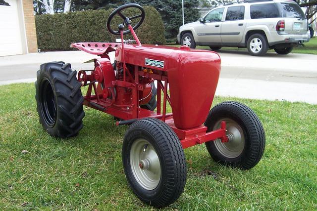

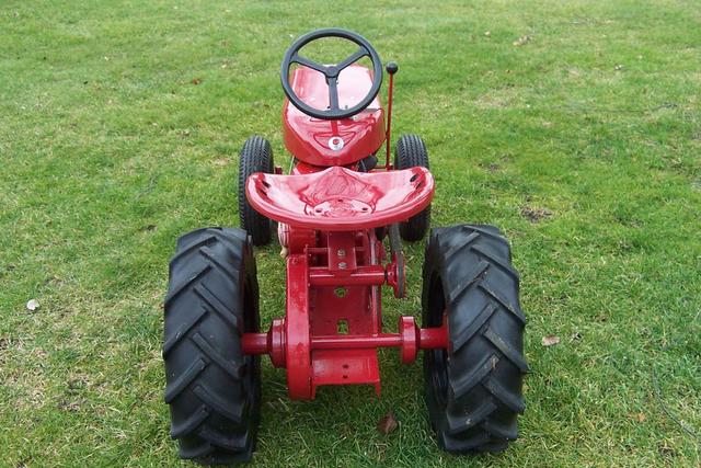

rj35hunter 308 #8 Posted December 27, 2011 Bob, on your earlier 55 RJ (Like most of mine) it should be a 7" pulley. Most of the first year in 55 was, then in later 55 into 56 they mostly went to the 6" pulley. The 6" will work, but I think the 7" is more correct for your model. Out of my collection, I have 5 original 55 models with the 7" pulley. I dug up some pics of the 55's that I hope helps show the pulley and how it lines up. I use the gates truflex style "A" belts & seem to work good. They are a 20" long belt from engine to variable speed pulley & 37" long from variable speed pulley to rear 7"drive pulley. Clay Share this post Link to post Share on other sites

droptopcop 11 #10 Posted December 27, 2011 thanks for the pics, thats what i needed. bob. Share this post Link to post Share on other sites
