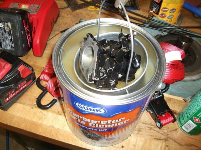

Sparky-(Admin) 26,358 #19 Posted January 1, 2012 So I ended up with this stuff since Tractor Supply didn't carry anything. Came from an Advance Auto Parts near me for $26 . Here's the first victim. Its the carb off my C-165 that runs but hasn't been running right. Bench cleaning and carb tweaking has not got it right so here's hoping this is the fix. Mike........ Share this post Link to post Share on other sites
Butch 194 #20 Posted January 1, 2012 So I ended up with this stuff since Tractor Supply didn't carry anything. Came from an Advance Auto Parts near me for $26 . Here's the first victim. Its the carb off my C-165 that runs but hasn't been running right. Bench cleaning and carb tweaking has not got it right so here's hoping this is the fix. Mike........ I was very disappointed with the Gunk carb cleaner kit. It wouldn't take the paint off and I was hoping it did. I've used Berryman products before and prefer them. Plus they're much cheaper. Share this post Link to post Share on other sites

Sparky-(Admin) 26,358 #23 Posted January 7, 2012 Extra air flow around the throttle shaft and/or gasket to the motor will also cause it to "hunt". no matter how clean the carb is. You can check by spraying carb cleaner around those areas and if it's sucking air, you will hear it in the RPMs. Improper float level setting can also contribute to the problem. Just a thought and something to look at if the problem is not resolved with a good cleaning. Mike, In addition to the things that John mentioned, make sure that your governor is adjusted properly when you're all done. You may have to reposition the governor spring to eliminate the hunting/surging. The procedure's in the Kohler service manual. You were right! After soaking most of a week the carb was real nice and clean. Got all the cleaner goop off it and reassembled the carb only to have it surge again. I ended up moving the governor spring to take up some slack and it smoothed right out. Makes me wonder if the carb needed cleaning at all, no harm done I suppose. I also redid some wiring and got the charging system back on line so this C-165 is battle ready again! Mike.......... Share this post Link to post Share on other sites
