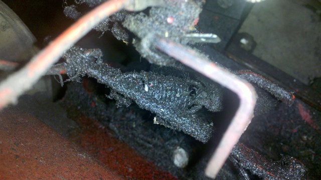

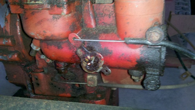

pulse301 0 #10 Posted December 23, 2011 when you rebuilt the carb, did you put in the spring on the needle that the float opens and closes? My carb kit said to NOT install that spring if the engine has a fuel pump. Also, here is a picture before I rebuilt my carb, I don't know if it will help you, let me know what you're looking for and I can take more pictures. Mine is a 1980 1100 special, but they are the same engine I believe. Best picture of could get of my governor linkage...I know, it isn't very good... Share this post Link to post Share on other sites
