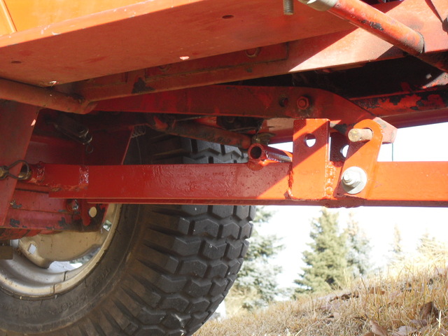

ce318 13 #4 Posted December 18, 2011 I will see if I can figure out how to post pic's some how as I dont use photo bucket. Anyway, I hooked up to a bracket underneath the tractor directly below the seat. welded a tab on the plow for the hydro lift. the plow shifts from side to side at the front maybe 2 inches left or right. The plow lifts up about 6" and I pushed some dirt around and it worked great. The only reason I did this was because of price and I cannot get WH plows around here. What I need to know is what was that bracket under the tractor is for and will I damage it. The bracket is about 7" inches across and part of the tractors undercarriage. The plow frame was long enough to extend out where the blade does not hit the tire when angled. Share this post Link to post Share on other sites

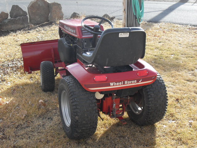

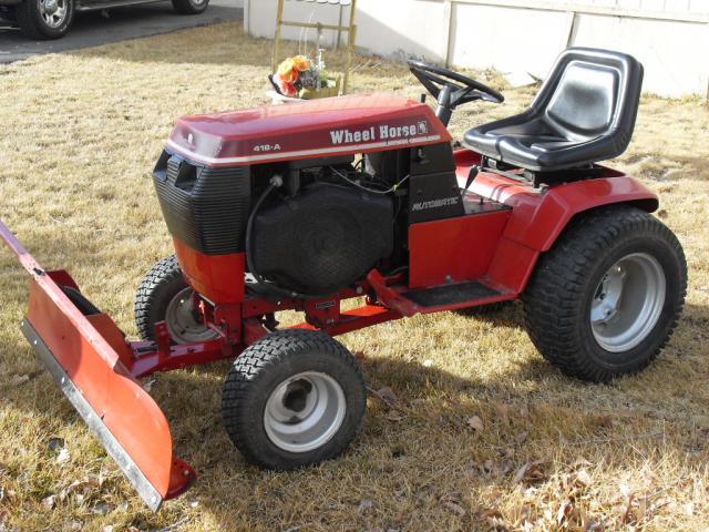

ce318 13 #6 Posted January 1, 2012 Ok, so here is some pic's that I shot this morning. If anyone has some ideas to improve this project, please let me know. I reinforced the rear conection. I am not sure about the lift mech. and I dont think it is heavy enough for dirt and gravel. It lifts well and seems solid. Chris Share this post Link to post Share on other sites
varosd 1,185 #7 Posted January 1, 2012 you want to fab or obtain a lift link instead of using the mower deck pin attachment. don't want to strain the hydro lift too much the silver thingy Share this post Link to post Share on other sites
ce318 13 #8 Posted January 1, 2012 I will try that. I didn't really like my solution that much and would rather have a direct conetion. Thanks for the picture. I will save it. My next move is to use a cable some how to release the blade angle lock. I was thinking some thing along the line of a old bike brake or an old throttle cable. Chris Share this post Link to post Share on other sites
varosd 1,185 #9 Posted January 2, 2012 there is a pinned Snowblade thread under resto/mods that is excellent. do you have a picture of the right side of the tractor? I'm sure that Crapsman was like all companys long frame Snow blades and had a right side angle handle. perhaps a a model search of Sears parts ( except it runs so slow)) or fab up a piece of flat iron with correct, some sort of pull cable. how were you looking to angle the blade. other than kicking it? LOL I'm sure this has been done before on a MTD/JD/Cub etc blade and someone will chime in before long Also, nice looking 418!!! Share this post Link to post Share on other sites
Sparky-(Admin) 25,204 #10 Posted January 2, 2012 I wonder if you need some sort of stabilizer to stop the plow frame from being forced to the left or right when using it in the angled position. The rear of a WH plow frame is something along the lines of 12" wide which gives the frame some lefty-righty strength. Mike......... Share this post Link to post Share on other sites
ce318 13 #11 Posted January 2, 2012 Sparky when I was a kid I had a MF12 and the plow was on a similar frame at the front of the was a hoop, open at the bottom about 4" wide and the hoop raised up about 10". there was a peice that was attatched at the front directly behind the plow that fit in the hoop to stabilize it. This is what I was thinking of doing. Don, I will definetly check that thread you mentioned I was thinking of fabing up a handle bar to the plow frame and attatch a bike/brake handle and cable. Thanks all of you for the input. I wish I was on the east side there would be more WH stuff and I would not have to build my own. However I am the only one here with a WH. Excuse the spelling and typing I am on the Itouch...Chris Share this post Link to post Share on other sites
