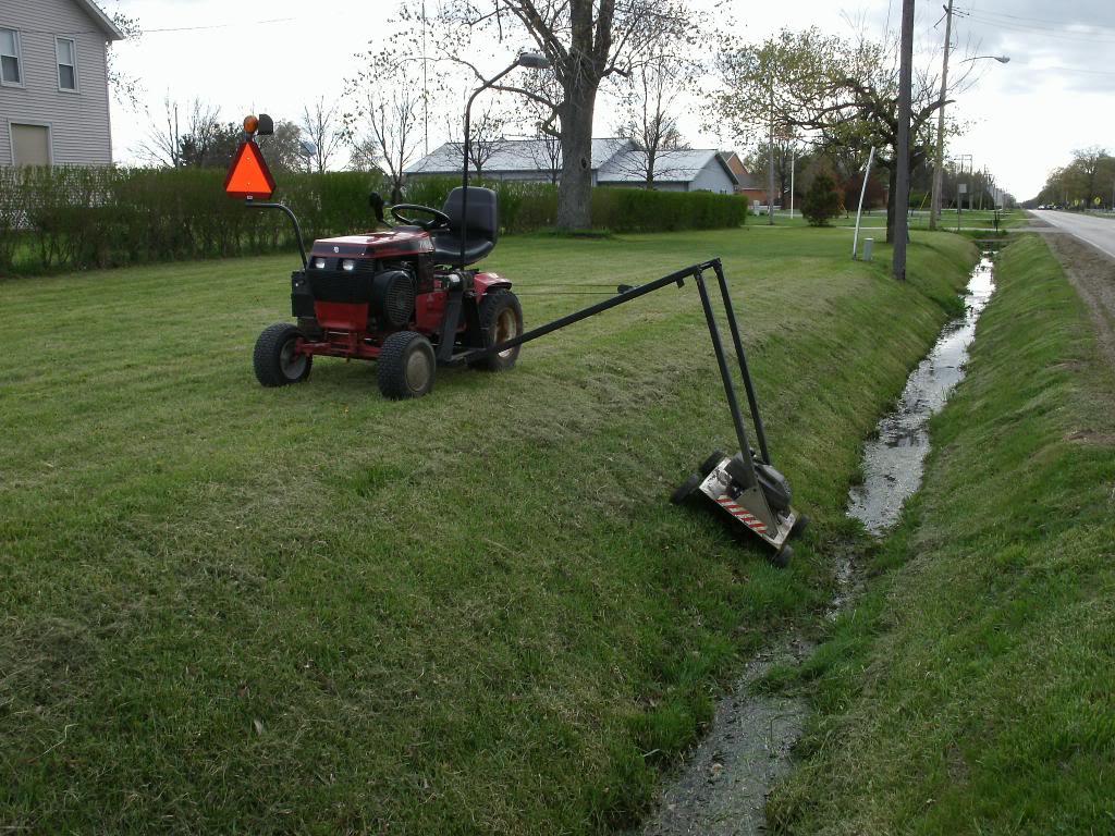

The toymaker 22 #1 Posted December 14, 2011 (edited) Here are a couple of photos of my ditch mower. The state thinks I need a canyon for a ditch, so after a year of weed eater tourture, I decided that there had to be a better way. I just took an old lawnboy and made a new aluminum deck with open ends, then made a frame and arms from square tubing. A harbor freight winch raises and lowers the arms with the control switch incorporated into the tractors motion lever. On the right side of the tractor, there is a car battery, onboard charger, and 200 pounds of steel which all serves as a counterweight. This was the sixth year I've used it and have had really good luck so far. The only thing I want to change is to make the unit quick tach so the tractor could be used for other things. Edited March 15, 2018 by CasualObserver replaced old photobucket pics with attachments 12 7 Share this post Link to post Share on other sites

Kelly 1,039 #7 Posted December 14, 2011 Very good thinking, and nice touch using a 2 cycle engine on a steep angle. Share this post Link to post Share on other sites

953 nut 70,648 #14 Posted March 16, 2018 The mower on the articulated arm would need to be a two cycle unit. If it was a splash lubricated unit it wouldn't last an hour. Share this post Link to post Share on other sites
