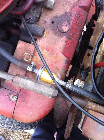

tunahead72 2,640 #29 Posted December 15, 2011 I did disconnect the pump at the fuel fitler which is before the carb and there isnt a drop of gas that comes out of it when its on and clicking away. Jeff, I think you're on the right track here, but just to clarify -- did you disconnect the line BETWEEN the pump and the carb? Is your filter in that section? I'm not real familiar with the K482 setup, but I don't know where you would have space to install a filter in that section of line. Or am I reading this wrong? Maybe a picture would help if you get a chance. For that matter, are you certain you're getting fuel to the inlet side of the pump? These pumps can be a little difficult to prime initially, maybe you have air in the line somewhere? I haven't looked closely at the service manual, you'll probably find some useful information about the fuel pump in there as well. The parts manual is also in Documents, and may help you identify the "proper" Kohler part number, but it's more complicated to read. In a very early section of the parts manual, there should be a chart that lists "variation numbers" for each engine system and spec. number. You'll use that variation number to identify the exact part you need (your spec should be 35209B if you still have the original engine on this tractor, check the label on the engine to make sure). Keep in mind, the variation numbers are not the same from one system of the engine to another. Share this post Link to post Share on other sites

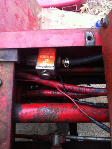

Hodge71 691 #30 Posted December 15, 2011 Ed, It doesnt have the factory prump on it. That pump apparently went bad at some point and was replaced with an electric pump. I did disconnect the line after the pump but before the filter. There is tons of fuel coming out of the line BEFORE the pump, but the pump doesnt move the fuel from that point up to the filter and carb. Share this post Link to post Share on other sites
