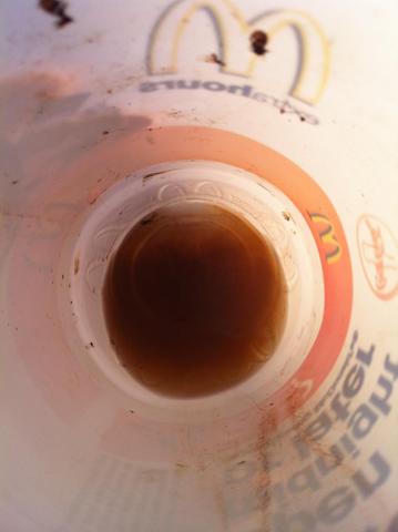

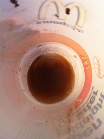

Hodge71 691 #8 Posted December 13, 2011 gas shouldnt look like chocolate milk Share this post Link to post Share on other sites
Rooster 192 #9 Posted December 13, 2011 You are supposed to pour the coffee out of the cup FIRST, then drain gas into it... :ychain: Share this post Link to post Share on other sites
