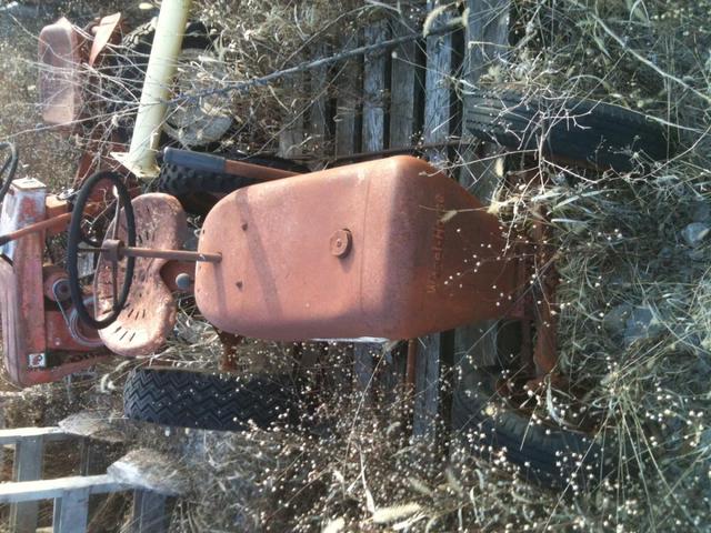

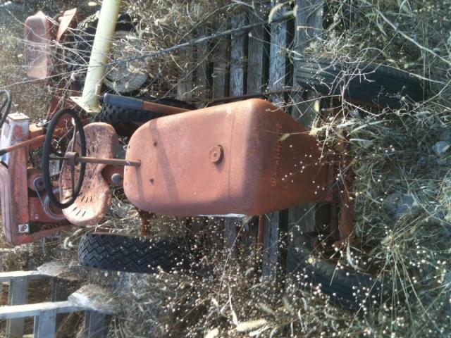

KSCPO 0 #1 Posted December 12, 2011 We have a storage unit facility and our renter quit paying so we have some Wheel horses left behind. Wanted to know where I could find a model number to figure what we might have. I believe there are 2 rolling chasis, 1 more with motor and then pallet of parts. Any information would be great and thanks in advance. Share this post Link to post Share on other sites

Rooster 192 #4 Posted December 12, 2011 OK Guys Correct me...I am testing my Skills here, lol The foreground has a straight front axle, Skinny rear and the seat stand makes me think RJ...and the "Wheel Horse" on the hood says Later model, So Somewhere close to an RJ-58? The Tractor in the background, Round Hood and forward engine says its a 7XX something... How'd I do? LOL Share this post Link to post Share on other sites
71_Bronco 1,073 #5 Posted December 12, 2011 Rooster, I too say RJ-58 or 59 on the one in the foreground. I dont know enough about the other Horses to name the one in the back. One giveaway for me is the shifter stick, I do not believe the RJ-35's had a stick there. Also the "wheel horse" on the hood as you pointed out also says RJ-58 or 59. I do notice two different rear tires on the RJ, wonder what the story is. Share this post Link to post Share on other sites
Kelly 1,038 #6 Posted December 12, 2011 First one is a RJ, a 58 or 59, the one in back with out a better pic, is a 702, clues that tell me that , steering wheel is a 62, 63 style, but the gas tank, is the 61, 62 style one piece tank with removable dash plate, and has a Kohler with starter/ gen. if everything is orig. and looks to be it is a 702. Share this post Link to post Share on other sites

TT-(Moderator) 1,185 #11 Posted January 9, 2012 The engine tag in the first picture is a K-161 for a 702 - which is in photos 3&4 and previously identified. The tractor with the giant steering wheel is a 603. It's hood appears to be the one in the second picture. Share this post Link to post Share on other sites
