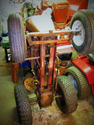

TT-(Moderator) 1,173 #10 Posted December 19, 2011 IIRC, aren't the frames completely different too? Yes - the frame on the RJ-25/35 models is made from a single piece of channel - whether it's extruded "iron", or formed steel plate. It also runs the full length of the tractor. RJ-58/59 frames are the more conventional angle iron "ladder" design which stops just behind the engine mounting location. Side note: RJ-35 models built after the Wheel-Horse trademark became officially registered will have the name stamped in the "grille" portion of the hood. To the best of my knowledge, this happened sometime in mid-1956. 1 Share this post Link to post Share on other sites
AMC RULES 37,259 #11 Posted January 2, 2015 Now there's a view of a '35... you don't see everyday. Share this post Link to post Share on other sites

AMC RULES 37,259 #15 Posted January 3, 2015 I think for comparison... an RJ-58 frame should be included here too. Share this post Link to post Share on other sites
