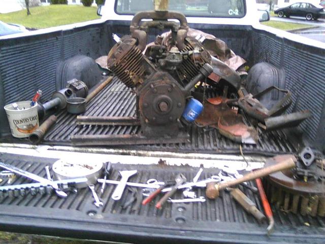

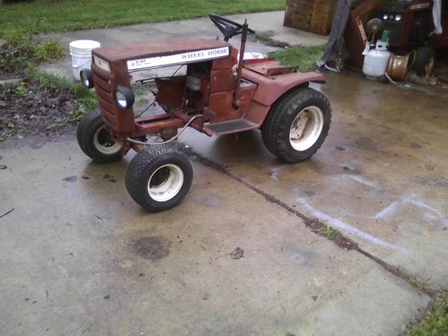

SousaKerry 503 #1 Posted December 4, 2011 Got a slight engine upgrade planned for this old tired C-81 I think it will fit.... maybe need to raise the hood and lengthen the frame just a bit 2 Share this post Link to post Share on other sites
SousaKerry 503 #2 Posted December 4, 2011 oh and it's only a 22 HP upgrade Share this post Link to post Share on other sites

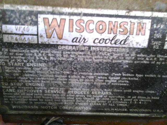

TT-(Moderator) 1,188 #3 Posted December 4, 2011 oh and it's only a 22 HP upgrade A Wisconsin VF4D is only rated @ 25hp - at 2400 RPM. I seriously doubt you'll need any weight on the front end with a ±300lb engine! Share this post Link to post Share on other sites
clyde 5 #4 Posted December 4, 2011 thats a vh4d isnt it? Share this post Link to post Share on other sites

SousaKerry 503 #6 Posted December 4, 2011 funny thing about the HP rating one source says 25 another says 30 so I'm going with the nice round number of 30. and I believe the 300+ pounds even the heads and carb are cast iron Share this post Link to post Share on other sites

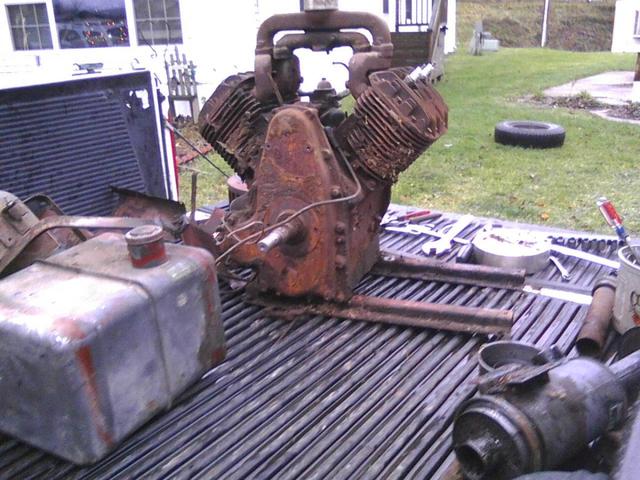

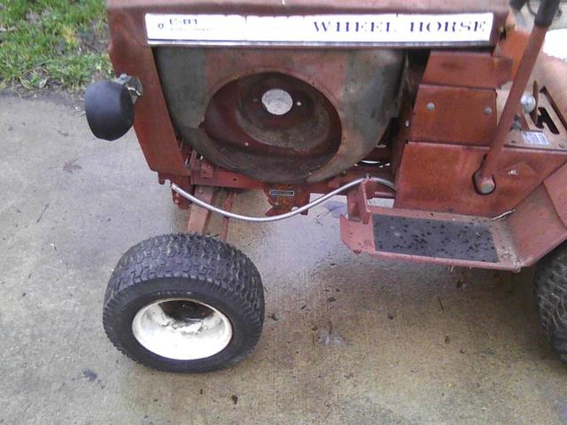

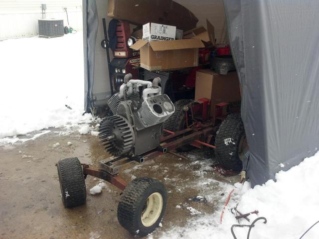

SousaKerry 503 #12 Posted December 11, 2011 Well I pulled off the heads today bores on the engine look factory fresh, pretty good for an engine manufactured in 1952 and sat in stored for the last 20 years, And I only broke off 3 head bolts, hard to believe the bolts were of the shelf grade 5, 5/16-18 should be easy enough to drill out. Had to completely disassemble and sand blast the carburetor, rebuild kit is on order..... I may actually try to start it by the new year. That is if Santa is nice and brings me a gasket set. Ben thinking about where to add the 6" to the frame, if I add it to the front it would give it an over hung look like a bigger tractor but I worry about putting that much weight over the front wheels. Whatcha guys think? Share this post Link to post Share on other sites
smoreau 658 #13 Posted December 11, 2011 Well I would add in front of the axle if you plan on using factory attachments, But if you don't plan on that I think it would look better if you added it to the center of the frame. Just my thought. Share this post Link to post Share on other sites

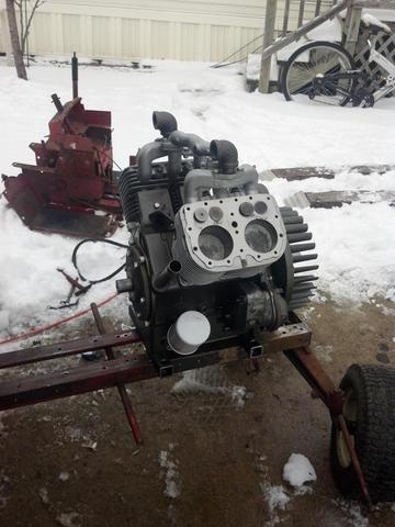

SousaKerry 503 #19 Posted February 27, 2012 Well I got the engine started this weekend took a total teardown and new rings, carb kit and lots of elbow grease, but the beast lives 1 Share this post Link to post Share on other sites
WH Raider10 17 #20 Posted February 27, 2012 Wow, that's awesome! I like that engine! :bow-blue: Share this post Link to post Share on other sites
farmer 1,081 #21 Posted February 27, 2012 Suddenly that frame looks very small, amazing what some of you chap's dream up, good luck with it, (hope you've started working out). :handgestures-thumbup: Share this post Link to post Share on other sites
COMMANDO1 23 #22 Posted February 27, 2012 WOW ROCKS THE WHOLE TRACTOR....SWEEEET. Share this post Link to post Share on other sites

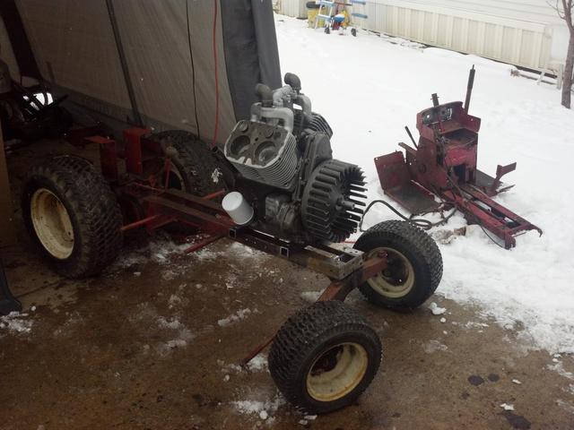

SousaKerry 503 #23 Posted February 28, 2012 That frame is stretched 6in already now its gotta get wider so i can mount the engine properly. WHEEL HORSE STYLE!!!!!!!!!!! Share this post Link to post Share on other sites
