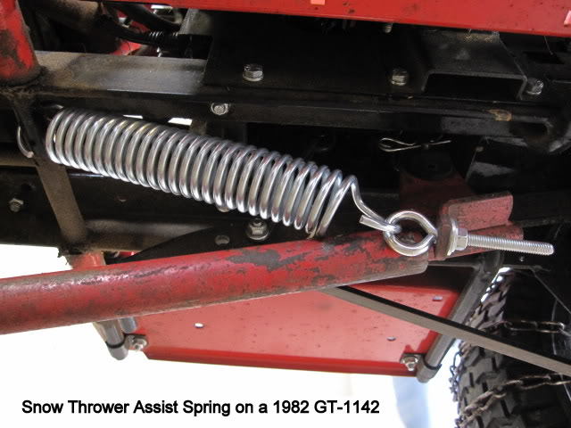

mdntspec 8 #5 Posted December 8, 2011 here is a pic... 1 Share this post Link to post Share on other sites

floor-it 11 #9 Posted December 11, 2011 Hi, I have a single stage 42" snow thrower and I use a spring assist also. The spring is from the a general hardware store. it is a Handyman Brand Spring SP-9629 for $5.00 The length =6.5" long. Detail Dimensions are 1.25" X 6.5" X .162" The capacity is 93.7 lbs which is perfect for the single stage thrower. The 6.5" spring length was also just right for adding an adjustment nut and stud. 1 Share this post Link to post Share on other sites
shameless 3 #10 Posted December 11, 2011 Thanks stevebo and floorit, I found what I needed at my local harware store. Share this post Link to post Share on other sites
