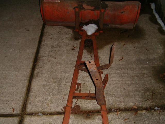

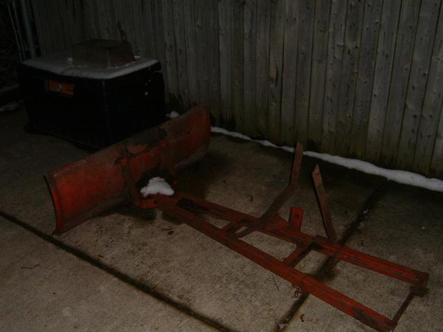

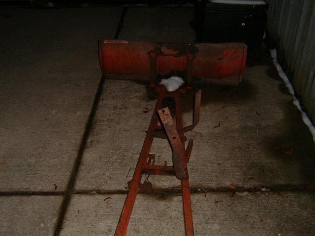

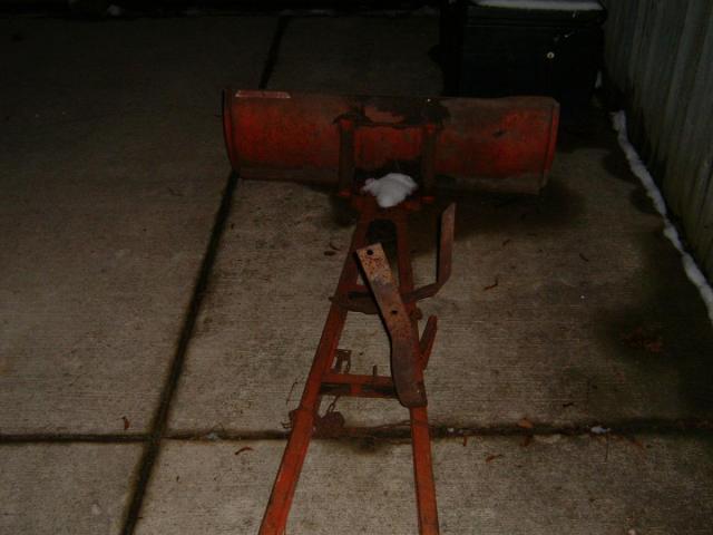

rdd52 0 #3 Posted December 2, 2011 this is the one i picked up i finally found my camera to get some pictures do you think this will work without to much modifications i don't want to chop it up.do you know what model wheel horse this is for?thank you for your time. Share this post Link to post Share on other sites
TT-(Moderator) 1,170 #4 Posted December 2, 2011 That appears to be a 6-2111 ~ which is the "more modern" version of the BD-4267. The angle lever & related linkage needed if you want to angle the blade from the tractor seat: Here's a drawing of the rear hitch for that A frame style. Unlike the newer models, the hitch plates fasten to the outer ends of the A frame mounting rod.: I thought I had a picture of the actual hitch, but haven't found it yet. Share this post Link to post Share on other sites
