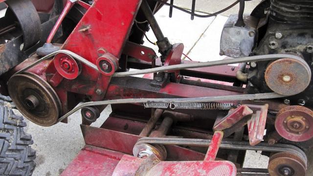

I found a pic of that setup on a google search.
post-5696-0-69906700-1322610498_thumb.jp
TT
That's almost correct, but that tractor also has a larger-than-stock engine pulley.
I'm pretty sure that the additional idlers were used to help "contain" the drive belt within the profile of the original belt guard design as much as possible - even though the lower rear portion had to be modified quite a bit.
The lower idler also help put more belt "wrap" on the pulley - which means less slippage under load.
