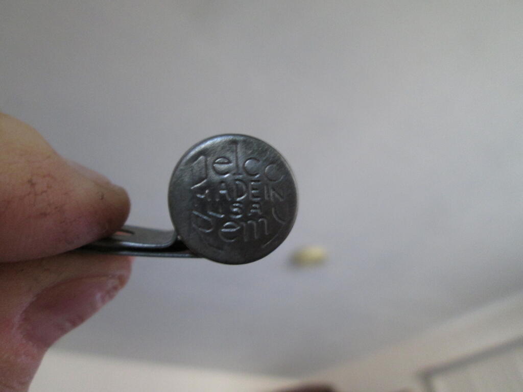

stevasaurus 23,884 #1 Posted October 31, 2011 I've got 2 10hsp Kohlers...Raider 10 and the B-100...the Raider 10 quit running about a week ago, and after some checking it out, figured it might be the condenser. I took the one off of the B-100 and switched it on the Raider 10. She started right up. I left that one on and I had one that I think is for the 1964 Ford with a 223 six cylinder. I put that one on the B-100 and she seems to work fine...started right up. I have searched the past threads and read them, and dabbled on the inter-net, but nowhere does it say (that I can find) that a condenser is nothing but a condenser. I understand what it does...my question is...am I in trouble for not using an expensive one from Toro that is specifically for a 10 hsp Kohler or will this one work? Will I get pitting on the points, etc? The one I used has the wire and is the same diameter...it is about 3/8" longer. It is a Delco D-204. Open for discussion on this. Thanks Share this post Link to post Share on other sites
TT-(Moderator) 1,185 #2 Posted October 31, 2011 All I have ever been told was to use a condenser for battery ignition on a battery ignition system, and a condenser for magnetos on a magneto system. There is a difference in the microfarad rating, (capacity, I guess you could call it) but that doesn't necessarily mean that an engine won't run with the "wrong" condenser - it just means that the condenser and/or points won't last long. Share this post Link to post Share on other sites

Buckshot 1 15 #4 Posted November 1, 2011 :wh: Steve, what TT stated is correct. If your tractor has a battery powered ignition, then the condenser for the Ford will work just fine. On my Kohlers, I only use Kohler points and condenser. All though in a pinch I have used NAPA points and condenser. You just have to state wether its for battery/ mag. powered ignition. :dunno: Share this post Link to post Share on other sites
stevasaurus 23,884 #5 Posted November 1, 2011 Thanks guys. Both the tractor and that condenser are for battery ignition. I only use this horse for leaves, snow and shows and riding around the block some times. I guess my concern is...is there a difference in the storage capacities between various battery ignition condensers and where would I find that information? That is what I can't find information on. Share this post Link to post Share on other sites
